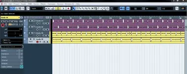

Hey, i just setup 5 mics and got it all setup and working and i noticed its always slightly off time.. so i double checked by recording a 5 track beat (simple 4/4 time with a metronome) and then recorded it again listening to the playback doing the exact same thing. then when i press play the time is really messed up.
- im not that great with the program... i hope its simple.

Heres an example:
x = hi hat.
Recording # 1 - x-x-x-x-x-x
Recording # 2 - -x-x-x-x-x

goes 3 then 3.2 then 3.3 then 3.4 then 4. one recording is on 3.2 and the other is on 3.3
I'm not sure what you are saying here. Delay (latency) is generally spoken about in milliseconds. It sounds like you have actual measures or something out of sync. Not latency.
Maybe you should post a screenshot of what it is you are basing the timing issue on, so we can understand what it is that is happening.

So, these are all drum mics correct? Which track is which drum. It is hard to tell what is happening from just the pic. Did you record these tracks all at once, or are they overdubs?
Please export a sample mp3 of what that is above.
