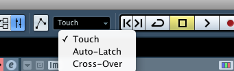

After you write the automation make sure you hit the read button so the program will read the new automation. What type of controller do you have?
it's a yamaha aw 16 g, i think i figured it out. you have to trip the controllers as the song is playing. after you trip, it replaces from there on. that doesn't make much sense though, i wish you could start where you want to without actually tripping each controller, or at least trip while the song is not playing and then write the new automation.

Ok, after a few hours of messing and looking i finally found it. On the track with the automation you should see a lighter blue section by the controls of the track, moving your mouse over it reveals an arrow, clicking that will expand another track under the uadio track. ou can also just right click on the control section of the track and hit "show automation."
Once on the automation track, you see a droop down that says mute, volume, and it will list any effects you have inserted. when you click mute, you will see a line running along your audio track, your mute button will follow that line. I believe you can also use this to add effects on just a portion of your track.
