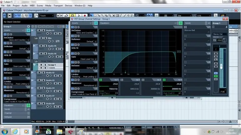

I tried applying these settings - Five Frequency Areas When EQ'ing the Vocal
From this article after numerous google searches but it says push to 5Khz but when i click e in mixer the minimum it'll let me drop it is 20?
