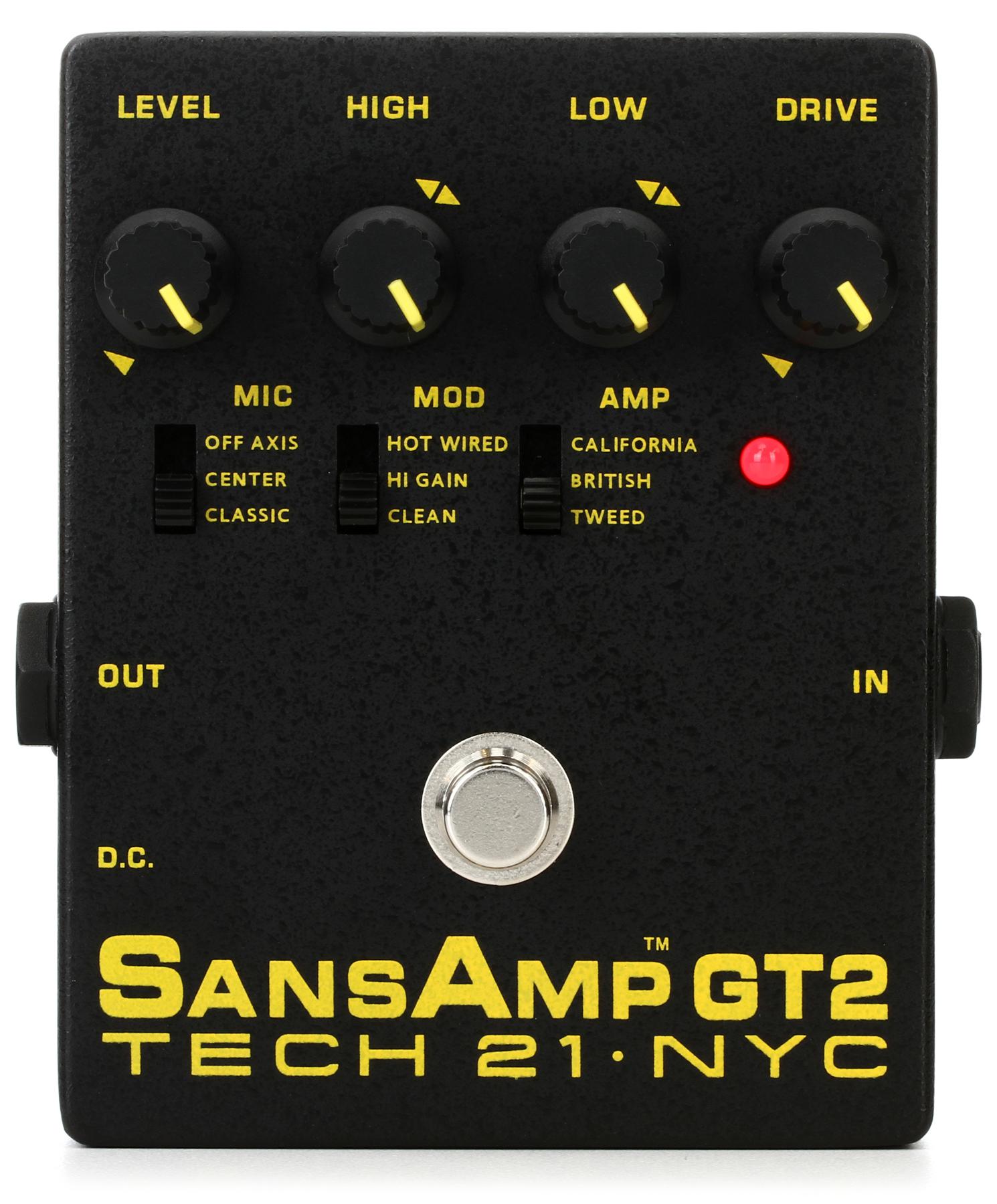

What do you think about using a SansAmp GT-2 as DI on electrics?
Regards,
Jim
Cheers :) Erm, I've only ever DI'd guitar a couple of times just through a normal DI box. They sounded okay for a clean sound, not great and probably too clean for a vintage sound. I'd just say give it a try and see what it sounds like.
aaronmcoleman
The truth is out there!
DI boxes tend to sound pretty "honkey". You really need something else. So if you have no amps GT-2 would probably be better than DI. I've never used one, but I know DIing a guitar usually sounds awful. Even with the pedals in front it's not going to be great. I would say try it and see if you like it, but that's probably a waste of time. If your options are DI or GT-2 I'd go with GT-2.
