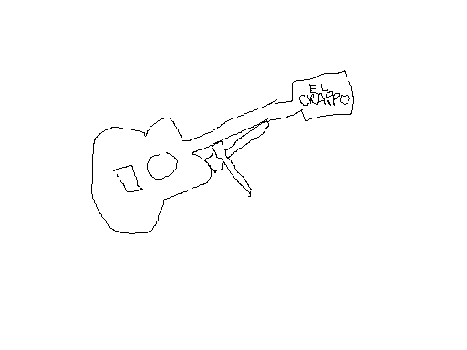

how's it micing top and bottom strings separately though?? i'm having trouble invisioning a difference in sound. so the mics are pointing vertical at the floor?? or is one mic parallel to the neck length of the guitar and the other pointing down at the floor?? hmmm...i'd be interested in seeing a picture of this
I'm envisioning it like this (forgive my weak skills with ms paint):
i'll join you in the crappy drawings club
i invisioned it flipped 180
Those drawings pretty much have it...Benny's being the closest, except that the capsules are pointed at the strings. So basically put your hand out flat, palm facing down...that's your normal XY configuration with the capsules being in the horizontal plane. Now turn your hand 90 degrees so the sides of your hand are facing left and right, that's what you do with the mics. I don't know if that visualization will help anyone or not. Basically the mic that points at the bottom 3 strings (G, B, and E) is pointing down from above, with the mic stand pretty much as high up as it can go and the arm extended all the way out...I even have to slide the long body of my SM81 almost all the way out of the clip. Then the mic pointing at the top strings (E, A, and D) is pointing upwards from the floor, as low as it can go. If I had the cord for my digital camera I would just take a picture and post it.
The mics aren't pointing at the floor...one of them is pointing "mostly" at the top 3 strings while the other is pointing "mostly" at the bottom 3 strings. It's tough to get it perfect...I just try to get as close as I can. The other thing I forgot to mention is that the guitar player can't be moving around. It gets weird if there's movement with the guitar.
