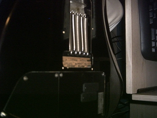

Put some wood in the cavity to keep the trem from moving. I dunno what a floyd rose looks like, but I provided a pic of my blocked trem. Sorry for the crappy angle, but the flash kept giving me horrible glare. Just above the wood (brown area) is the bridge. This is a pic of the back of the guitar, in case you were really confused. The wood is wide enough to prop itself against the edge of the trem cavity and up against the bridge.

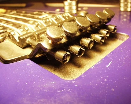

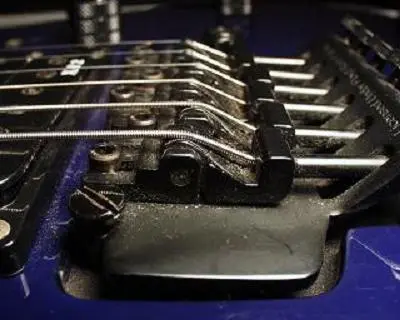

So I have the whole tuning thing down. But, I realized that this is not like any Floyd Rose I've ever seen. The strings load from the back of the bridge. (see attatched pictures) Comments anyone?

My Floyd loads from the back. Just to make things more complicated, it also looks like you need a strobe tuning.
yeah the saddles seem to be a little wierd there, it definitely needs to be intonated or he will never get it to sound in tune.
