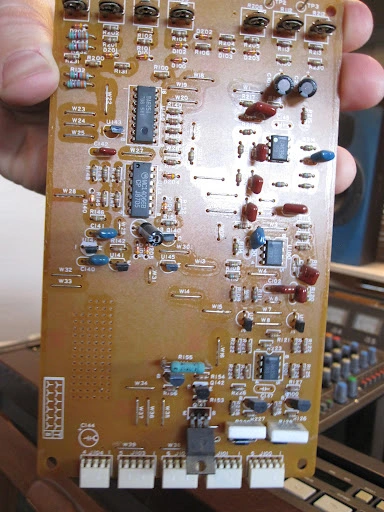

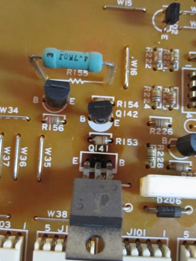

I reseated the cards to the right, and noticed a heat-damaged area on the Reel Servo PCB. ANyway, this could be totally unrelated, but I thought I'd post pics. Something I should replace? What is that part?
Thanks.
Power transistor. They get hot. Its okay. Even if it was toast it wouldn't cause noise in the audio path.

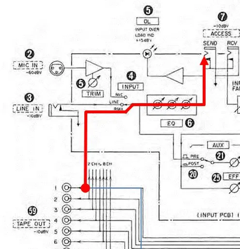

I don't quite understand (not seeing on the pictogram) the signal path to this send we're testing. In line mode, the problem isn't heard, so I assume this means the problem is before the switch. In RMX mode, AND with all cards out, the problem is occurring at the send, and at the stereo outs, but not at the tape outs. Does this narrow things down?
I'll take that info and compare to the logic diagram and schematics and get back to you.
So, just so I'm clear, no dbx or amp cards installed, input sourced to "rmx", noise is heard in all 8 channels at the "send" jack and the "stereo out" jacks but not the "tape out" jacks 1 thru 8, correct?
Maybe I'm missing it, but I don't see the signal path to the channel send on the pictogram signal chart. Can anyone explain the path, particularly in RMX mode?
When you can hear the noise in the stereo out jacks, are you also able to hear it in the monitor out jacks and in the headphones?
