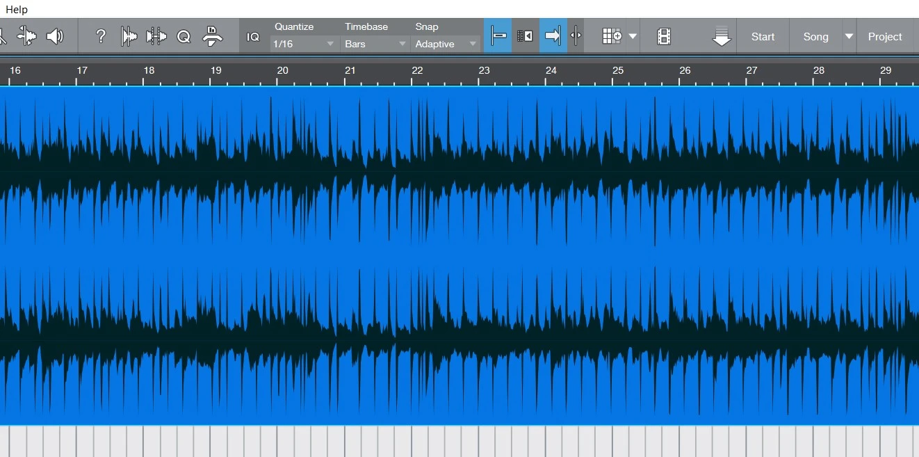

Found that the kick and snare peak as crazy transients all through the song, see pic. That can't be a great thing...

Sounds good. For the snare transient peaks you showed in that picture. I wouldn't bother too much. In the end it can be squashed with a limiter. The snare hits are a very percussive sound and the transients are (by definition) short time periods, so there will be no big loss in quality for the song overall.
Thanks. The thing is...that image was the final mixdown (of one of the earlier mixes) so the limiter had not dealt with them at all it looks like. The thing concerning me was that my idea of mixbus compression is to glue things into a cohesive unit...but with these crazy snare spikes I get the feeling the body of the song is not really even being addressed by the stereo compression...only the peaks. The makeup gain is turning up these peaks and the body of the mix/ song doesn't get glued. What I worked out is that (I use ezDrummer) the overhead channel contains 99% of the snare/ kick volume and tone. The individual snare/ kick channels could literally be muted in my DAW and nothing would change regarding the kick and snare volume and tone in the drum bus. Crazy! So I realised that my problems were not on the snare and kick channels (I spent 3 days putting every plugin known to man on the snare channel...for nil result)...but in the OH's. At that point I had options...a) turn off all bleed in EZD, lower the OH's then mixdown to audio, b) do nothing to the EZD mixer, mixdown to audio then high pass the OH channel so that it largely eliminates the kick and snare, leaving the cymbals and hihats etc.
