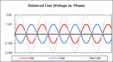

I was thinking [really!] about it. If you short the Ring and the Sleeve, you're adding the Cold + Ground. Suppose a 0 volts ground, then basically you have the cold. So now you have a moving voltage reference, which is basically you're signal out of phase. This will change your readings, multiplying your voltage by a factor of 2. Am I right?
So is it correct to asume that a balanced signal carries at the Hot 1/2 the voltage of the original signal?
(I am attaching a little chart about it) Cheers, Andrés

Yes, but that won't happen because nobody would design a circuit that way :)

You are partially right, except that a balanced signal carries full strength signals on both conductors....one out of phase as you've drawn there. The two are *added* together at the destination, which leaves you with your noise which is then subtracted from the in phase signal.
In other words, no, a balanced connection does not carry 1/2 voltage on each line. Yes, you're theory is correct that if you added the cold + ground and the receiving circuit subtracted ground from hot, then you should end up with twice the voltage. I don't think that is something that will happen in this case, however.

Reading round I found something like this
"Remember that in a balanced circuit, both signal wires carry the same voltage level with reference to common, and they are 180 degrees out of phase. In this case only half the voltage will appear on the meter, so the engineer must mentally double the voltage level when making a reading."
(http://www.montagar.com/~patj/db_db.htm)
And something like this:
"The loss of this signal would normally mean only receiving half of the signal voltage. The cool thing, though, is that the transformer automatically compensates for the lack of the third wire and delivers the correct voltage to the unbalanced input anyway! "
(http://www.fmraudio.com/balanced.html)
The first one is quoted by Digidesign as a correct procedure, the second one is from the makers of the Real Nice Compressor and Pre.
So, what's the real deal about this? It can't be that hard to establish. Is it time to use the Harvey-signal? :-)
Cheers, Andrés
