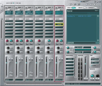

if your profire can work in slave mode then it will work, you just need to configure it in whatever recording software you are using.
You'll only get two channels across the spdif Input. Just add a strip to the EMU Patchmix software for the spdif. Then a send to an ASIO In. Mine goes to ASIO In 1/2.
Sorry, the image is kind of small.

Wow, thanks guys! Just got me a cable, ready to try it out!
