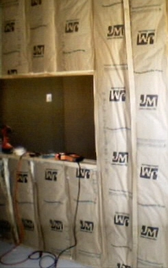

Do I need to have laminated glass or can I go with single pane 1/4 and 3/8?
The window is 54 inches by 27 inches. The wall has 2 by 3's and share a common 6 inch base(bottom plate, sill).
If your planning on having clients other than yourself plan on using laminate glass for liability reasons. If you just plan on doing hobby recording for yourself and some friends then the 1/4 and 3/8 will do ok.
