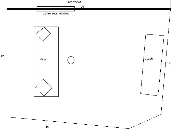

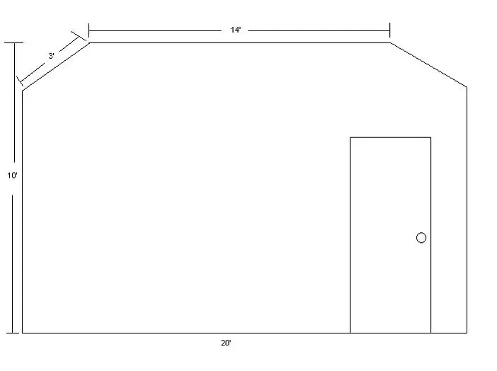

I am currently building a new control room off of our live room. We are building from the back wall of the live room out into a finished barn, so the L & R walls and ceiling are already insulated. For the back wall we were going to put multiple layers of sheetrock and insulation as well. I have attached 2 diagrams for the design of the control room and would appreciate any and all feedback. As far as treating the room I am planning that already, but I'm more concerned with what everyone thinks about the design itself. Excuse the drawings :o :o

Dudop,
Have you already started building?
1. the room is Asymmetrical
2. the cr/tr window is in the reflection zone
3. the base dimensions are multiples of each other
None of the above are good. get a copy of my Room Mode Calculator found on my publications page and figure for a rectangular enclosure first.. Then you can treat the room. Some very good articles for treatment can also be found on the RealTraps site and the GIK site.
Good luck with your build, but remember, "Good studio building is 90% design and 10% construction." (- Andre Vare)
