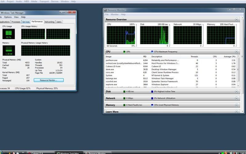

Take a look at the pictures attached. My disk meter in the VST Performance popup does not register at all (the overall subsystem there is pretty decent). I've got a mix going with a lot of plugins, but only 38 channels going on in the mixer (tracks and groups).
My CPU usage in Windows Task Manager bounces between 25 and 50 percent.

Alright, so my band recorded a little jam we had. And I had buffer settings set to 256 and norton antivirus, firewall, antispyware off.
I hit about 50%+ on the cpu usage
And here's the info about the what's going on
I noticed that my disk is going crazy... which is pretty unusual. But it is probably because I had the Alesis DVD-rom in the DVD drive and forgot to take it out. But that might not be the case. I notice that in my processes there were quite a lot of svchost in it when I checked "view processes from all users box".
1. Is this a laptop used by several people and/or logged into under various names? Instead of switching users, which can leave processes running if I am not mistaken; try fully logging out every user and shutting down all other applications before starting up your "session".
2. It is obvious you have "speed step" running, if that is what it is still called, which controls the processor speed according to the load to be processed. This generally is not good for audio applications. Find out how to disable this on the laptop. I don't know how to do this for your laptop. As I said above, if you try to run the laptop on batteries only after doing this little modification, the batteries will not last long at all. Whatever you do to change it, document it so that you can put it back for when you really do need the laptop for something else and need to run on batteries.
3. Taskmgr.exe is showing 50% CPU use here? Whew. Speed step. Turn it off. The processor speed throttling is generally not able to keep up with the real time demands of an audio application.
4. Your disk io appears to be very much under control as the increment showing seems to be 100K per division. If it is flashing red in Cubase for the disk meter, THAT would indicate a problem.

Yes, disable the variable speed control. It would be in the BIOS. You want the full speed available at all times for the audio processing. There is no time for it to "ramp up".
The 2 main drawbacks are battery life before needing recharged (but you have it plugged in anyway most of the time), and heat generation. Just make sure the laptop is well ventilated, ie, don't set it on carpet or fuzzy surfaces etc. If the laptop does warm up significantly, slightly prop up the back end of it to improve air circulation.
And I'm not saying this will solve all of the problems, but this is now a significant start.
