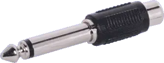

I just got my Reloop ADM-5 Monitors and the cable to connect the main one with the interface is double RCA. However, my audio interface's outputs are made for big jack (that's how you call it?) cables.
Do I need an adapter for it? RCA>>JACK
Will this thing work with an adapter?

Yes, with 2 female RCA to Jack adaptors,
or new cables with RCA male one end and male jack the other.

Sounds like you got a stereo jack to 2 RCA cable, that's not what you want, get what I said before.

It think we are loosing something in the translation, the cable you got will work, but you are hearing the standard computer output not the audio interface output? I think?
The adaptors or cables I showed you would be available in any electrical component store, they are also easy to make if you buy the plugs and cable. If you don't have a suitable shop nearby, try a stereo repair guy, he may make them for you.

okays, I will buy it once someone officially confirms that 2xRCA - 1x Stereo Jack cable
isn't good, and even though it seems to work well, I should get 2xRCA - 2x Mono Jack

If the stereo plug to 2 RAC plugs is plugged into the 1/8" stereo plug on the E-MU, than thats OK, if it's plugged into one of the large 1/4" left / right jacks than you won't get both sides of the stereo. You will have to get 2 leads with a mono jack and an RCA plug on each.
Most interfaces don't have a stereo plug option, that's why I asked what you had.
