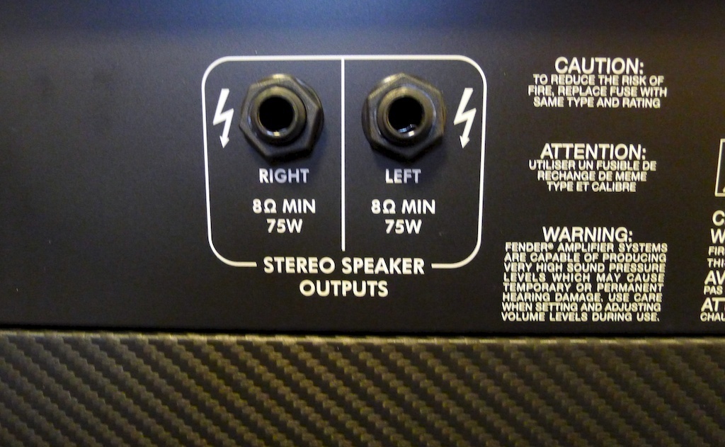

I have been able to discover that the head is rated at 150watts. What I cannot find out as yet however is the impedance into which that rating is given.
It is most likely into 4 Ohms and in that case you would have little to worry about since the power into an eight Ohm load would be only some 80-90 watts and I would guess the crate drivers are each rated at 60-80W?
If however that 150W is into 8 Ohms (as in Gregs photo) then it is unlikely that the cab would be completely safe from that amp. Guitar speakers should be rated at least 50% above amplifier power.
