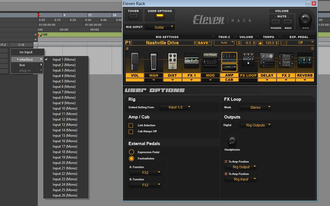

Here is my situation:
I've been searching a lot about hooking up Profire 2626 and Eleven Rack together and I finally found one. Check here http://https://www.youtube.com/watch?v=W0DRUGqfQ8o
Now, the problem is that the video is almost 4 years old and it has a different interface than mine. I followed how he connected the two with S/PDIF cables. But then, I came across this forum and it seems that It only needs 1 S/PDIF cable to make them work. Here's the link Profire2626 and Eleven Rack [Archive] - M-Audio Legacy User Forums
Which one is right? I have tried them both I followed how he set up the Eleven Rack on Protools. But I cant still get them to work because I don't know how to set it up on Protools 10 and 11. I managed to set the clock of the eleven rack external and the Profire internal.
In the video, if you do it right, you are supposed to get an input S/PDIF left-right and I don't see that happening in my Protools 10 and 11
