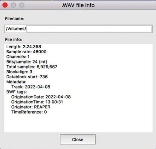

If you look at the source properties of the tracks with the blue icon, what does it say (right click on the track and pick Source Properties)? What does the upper right corner say?

I think this was all down to the rendering process, and not changing the rate to match what it was recorded at.
Speaking of which, how can I change it to 48000, as it always displays 44100?

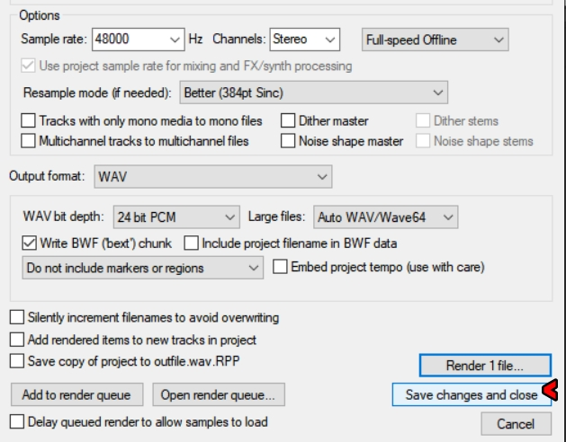

When you go to the Render process, there is a button for save changes and close. Just set the rate to what you want and hit SAVE AND CLOSE.
Thanks - I don't have that button in my version.
I can save, but when re-opening, the setting is not updated.
(I'm wondering if there's a global setting to control this.)
Rich must be using an old version of Reaper. Newer versions have a Save Settings button in the bottom right corner of the render dialogue box next to the Cancel button. This will save the settings for that project but not globally for all projects. I think you will need to save your preferred render settings, then go to Project Settings in the file menu and click the "Save as default project settings button" in order to save it as the default for all new projects. Remember that old projects will keep their existing settings though.
I'm on V5.99. It has the button on the Win version (see the red arrow in the dialogue box above), maybe the Mac version doesn't have it.
I didn't upgrade to 6. I got my license around v 4.3 I think. There's been no big need to upgrade, everything is working fine on mine.
