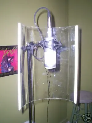

I just found this interesting eBay auction. It gave me a chuckle.
http://cgi.ebay.com/Condenser-Micro...466QQrdZ1QQcmdZViewItem?hash=item160097006373
Condenser Microphone Refractor Shield !!!
BEST THING EVER INVENTED FOR RECORDING
Condenser Microphone SHIELD (DOES NOT INCLUDE MIC OR STAND) I CANT START TO SAY HOW GREAT THESE SIMPLE THINGS ARE. BUT I WILL EXPLAIN BEST I CAN.
1.BEST THING !! THE SINGER CAN HEAR !!!!! PERFECTLY !! EVERY CENT OF DEGREE OF PITCH !!
BY PULLING OFF ONE SIDE OF YOUR HEADPHONES, AND PUTTING IT BEHIND ONE EAR U CAN HEAR YOUR NATURAL VOICE !!
2. IT ISOLATES FROM DAW CLICKS AND ROOM NOSE FROM BEHIND THE MIC
3. IT REFRACTS SOUND THAT GOES "PAST" THE CONDENSOR BACK INTO THE MIC !!!AND BACK TO YOUR EARS!! WE WORKED MANY HOURS COMING UP WITH JUST THE RIGHT AMOUNT OF BEND AN ANGLE TO MAKE IT WORK.
4. ITS A MUST FOR LOW VOLUME INSTRUMENTS ! WATE TELL YOU HEAR A SMALL BODY GUITAR IN IT !
Ad should read:
"I worked so hard on this and it sounds so great that I just had to sell it. It makes my mic sound so good, I don't want it anymore."
Can you say "1KHz comb filter?" The frequency response plot and sequence of nulls is left as an exercise for the reader...
Statistically diffuse, coherent reflections within a 5 ms window of the signal work great to create a live yet dry sound (a la Quick Sound Field), but with no venting and no diffusion, this thing just creates a classic comb filter. Eek!
Cheers,
Otto
Cheers,
Otto
yeah, what he said.

I'm not surprised. Lots of folks are used to the sound of comb filtering. After all, lots of monitors sit right on consoles and reflect off of all sorts of flat surfaces arranged around the monitoring location.

Or perhaps the comb filtering sounds better than the ambient sound of the room without it around the mike?

Heh, maybe this could be good for compensating bad monitoring,
now I get it! Cheaper than minitraps!
Just carefully adjust -as he describes- for the nulls
of the control room.
Matti :D
