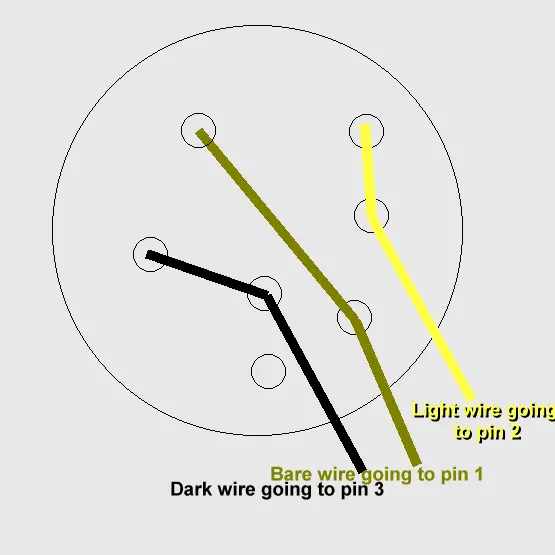

I'm still having problems with my cable. It appears that none of the 1/4" jacks of the combo jacks work. Most of the XLRs work. Some just need some adjusting. Half the returns work, but I should be able to fix those. I don't have a clue about the 1/4" jacks, though. This is what I got.

Also, should the metal 1/4" jacks be touching the metal plate?
