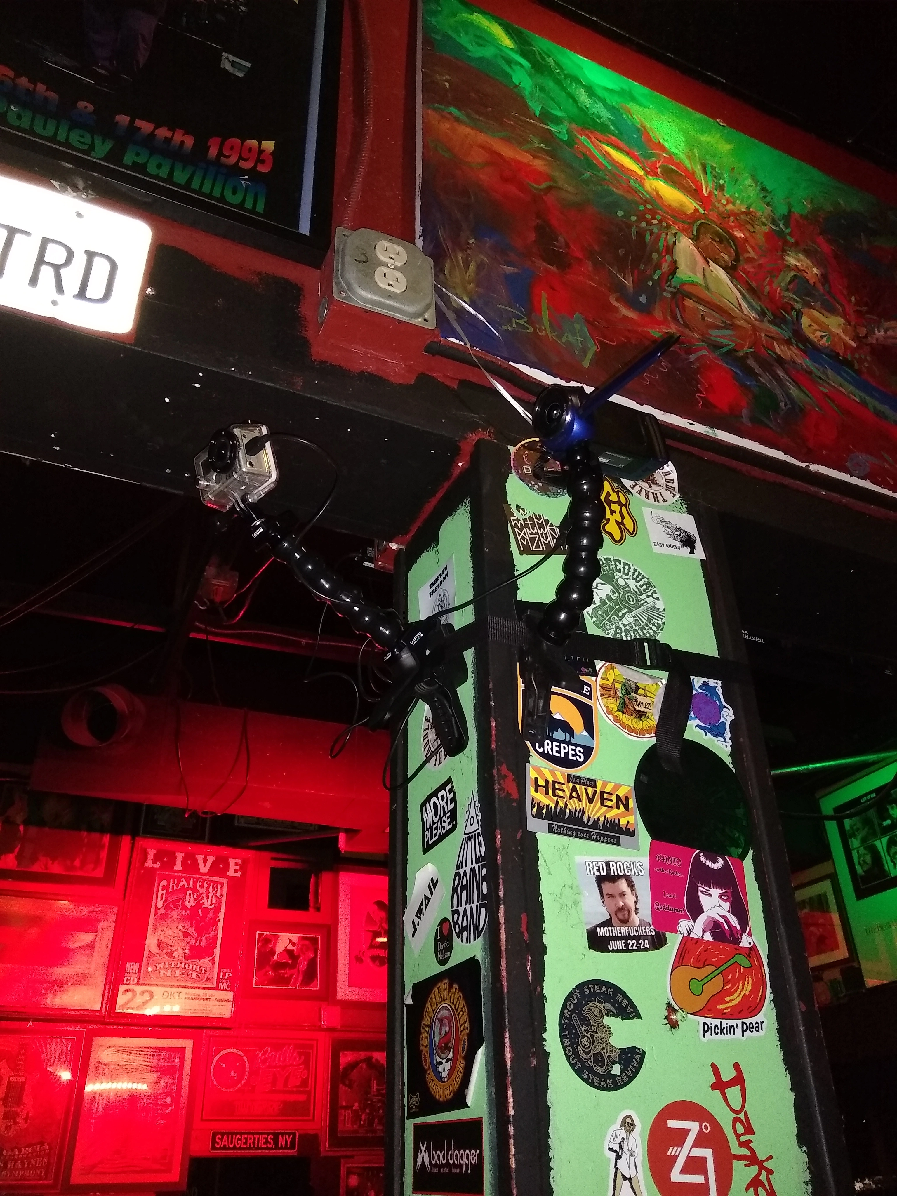

There are various lights that will go on a camera shoe or 1/4" 20TPI camera mount. The floor is a terrible place to put lights. I've been using more clamp mount solutions for my cameras and I may do the same for lights if I go that route. One trick I came up with was to bring a strap with a cinch buckle. I wrap it around a pole or post and use it to hang cameras using my flexible arm camera clamps.
