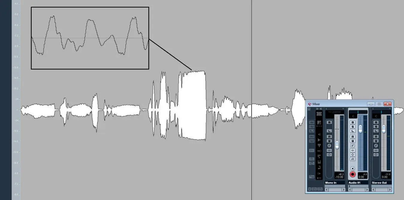

How about posting a screenshot of what you are seeing in Cubase.
No, the clipping occurs in the middle of the sound and plosives are not involved. I'm using a popshield.
Here is a screenshot.
