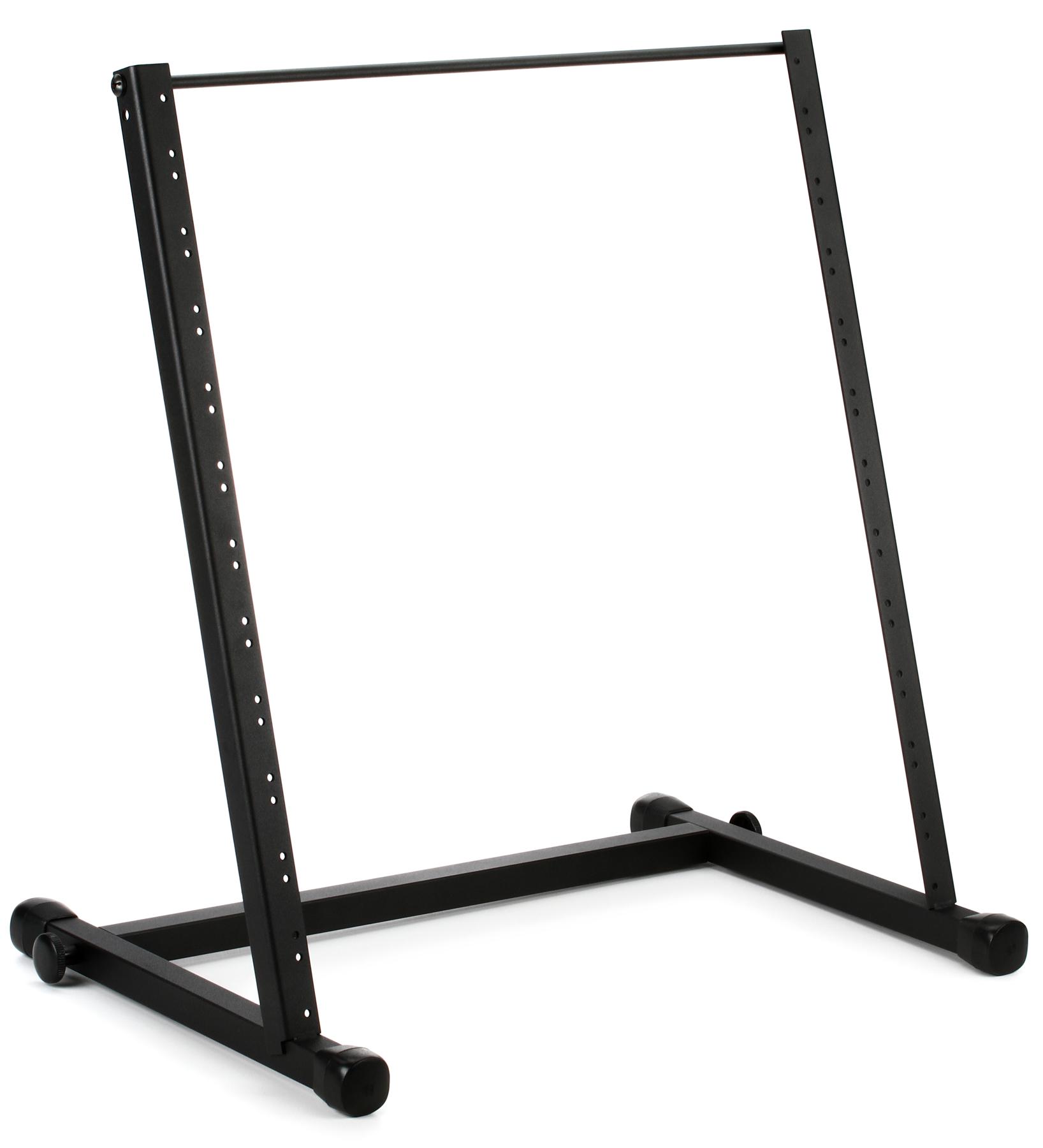

If they aren't leaving your studio you might want to look into the free standing rack frames - they are just a simple metal frame.. very inexpensive
I have one of those, but it is on wheels and the angle is variably adjustable from vertical to horizontal. Surprisingly sturdy once the gear is installed. The open access is ideal for me until I get around to wiring my patch bays. And I believe it was only $60. Comes disassembled, so shipping was not an issue. I can't remember where I found it tho. I'll search around.
Here it is. But It must have been on sale when I got mine.
Cheaper at Amazon. :D

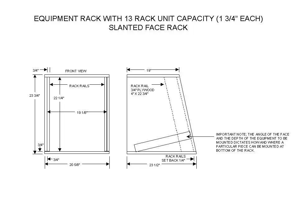

Homemade Slanted Rack
I built a rack similar to the middle one in your photo (see below).
Mine has 24 rack spaces total.
12 top and 12 bottom.
Primary pieces are two 3/4" X 16" X 48" glued panels that are currently about $16 each at Lowes.
It would probably cost about $50 or so to build plus whatever was spent on rack rail.
The basic one without the wheel base is $32.50 shipped on ebay
