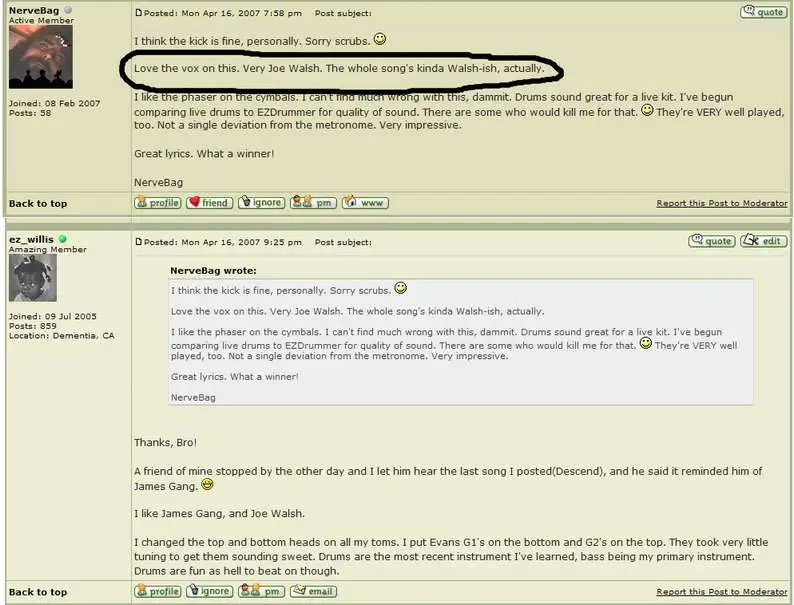

Really dig this....vocals remind me of Joe Walsh...tune has a cool swaggering vibe to it....can't really offer mix comments as I'm listening on some crappy speakers at work....al I can say is it's really catchy and rocks well!! ;)

Funny. This is from RP-

Song is cool....I do hear the Walsh references....but I like him.... :D
