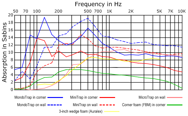

OK, here's a handy graph...
apl said:
Realtraps are membrane absorbers, not fiberglass panels. 4" foam starts nosediving below 250Hz. The MicroTraps aren't really intended for low frequency absorption, either, which is usually what needs the most attention in project studios.
Awesome graph, thanks! Looks like there's really no substitute for the Mondo/Mini Traps. But the auralex foam could be a very suitable replacement for the MicroTraps. Maybe I should go with the Mondo/Mini Traps for bass absorption and some Auralex foam for reflections?
