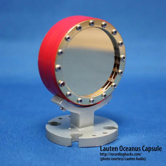

...I'm trying to get a sample of one of those too...I also heard that the same Chinese manufacturer will be offering an oversized 38mm LDC capsule shortly...my source said they are still fine tuning the response...that badboy's gotta have some serious bottom-end on it...should be interesting...I suspect it will be a Chinese version of (or similar to) the Lauten Oceanus edge-terminated capsule below (kind of a jumbo C12 capsule)...
