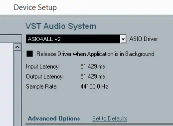

I'm using ASIO4all v2.13 if that's what you mean, and recording at normal 44.1 kHz, 24 bit. Sorry, I don't know much about drivers and such, so there may very well be something there that I've missed. The buffer size seems to be set to 512 samples.

Are you sure that in your DAW, you've set it to use the ASIO4ALL drivers instead of the default ones? One of the local Cubase experts can outline the process for you, I'm sure.

I am 100% sure that I've set it to ASIO4ALL, yes. Checked it a couple of times now.
