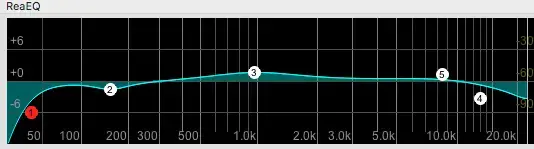

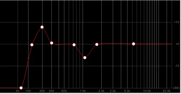

I did find it a bit heavy on the bass side, and the guitars are a bit *too* thin and in the background, I thought. I messed with mid side processing just to see what would happen. I ended up with a crazy looking boost at around 200hz in the sides. haha
Here are the curves I was experimenting with ...
Mid
Side
