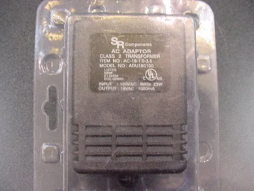

Hey Stevie,
Just google 18VAC Power supply.....M-Audio even makes a 3.5 amp one.
Probably pretty pricey.....
18VAC is standard Security Panel power. Usually 1-Amp.
Here is one I found at VETCO for $21.40 Each
Good luck!
