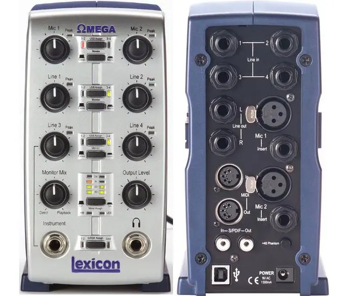

isn't it better to run the pre-amp outs into the Lexicon Line In on the back?
or did I miss something again?
and I always mute before power down....I don't like the sound of that "popping click" going through the tweeter.
Lexi-Four servo-balanced TRS line inputs with up to +22dBu input levels let you hook up everything from keyboards to guitar preamps, including high-output professional gear. Stereo digital inputs are available via SPDIF jacks, and an additional high-impedance instrument input is included on the front panel for easy access to guitars and basses.

OP, Coolcat is right, use the line in. I am generally too lazy to look at every piece of gear people use, but Coolcat was not!
Also, even though you didn't say you were doing this, it's not possible to pass phantom from one device through an upstream device like that. Without getting technical, that just ain't the way it works.
