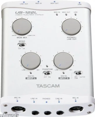

The Tascam US-122L can be found for around $100 and is very ez to install and use.
