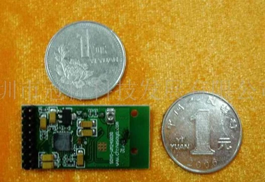

2.4G Digital Wireless Microphone Module
Features
Digital audio with 64K sampling rate and 16-bit resolution.
Low power consumption.
GFSK digital modulation/demodulation.
20Hz ~ 20 KHz audio frequency response.
90dB audio dynamic range.
Power-on function to prevent pop noise.
Avoiding reception errors by employing forward error correction (FEC).
Operating at 2.4GHz ISM band with 20 selectable channels.
-85dBm receiving sensitivity, 45dB channel rejection and application distance up to 130 meters (L. O. S. ) with perfect reception.
