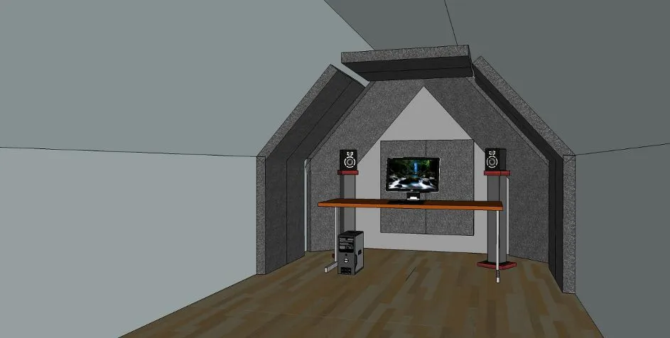

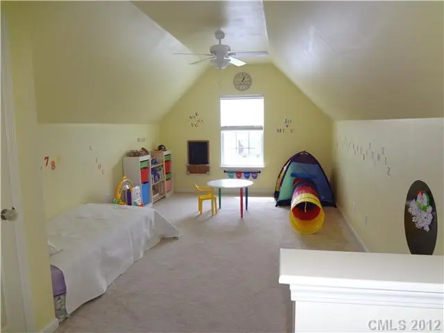

It'll work. However, seeing the width of the room and the angled ceilings, you're gonna need lots of absorption. Think fabric covered Owens Corning/Knauf rigid fiberglass panels. 4" thick 703. Here is a simple illustration. Lot's more to add, but for a quick model...it should illustrate the point. Come back when your ready. Oh, btw, this is only my opinion for what it's worth.
