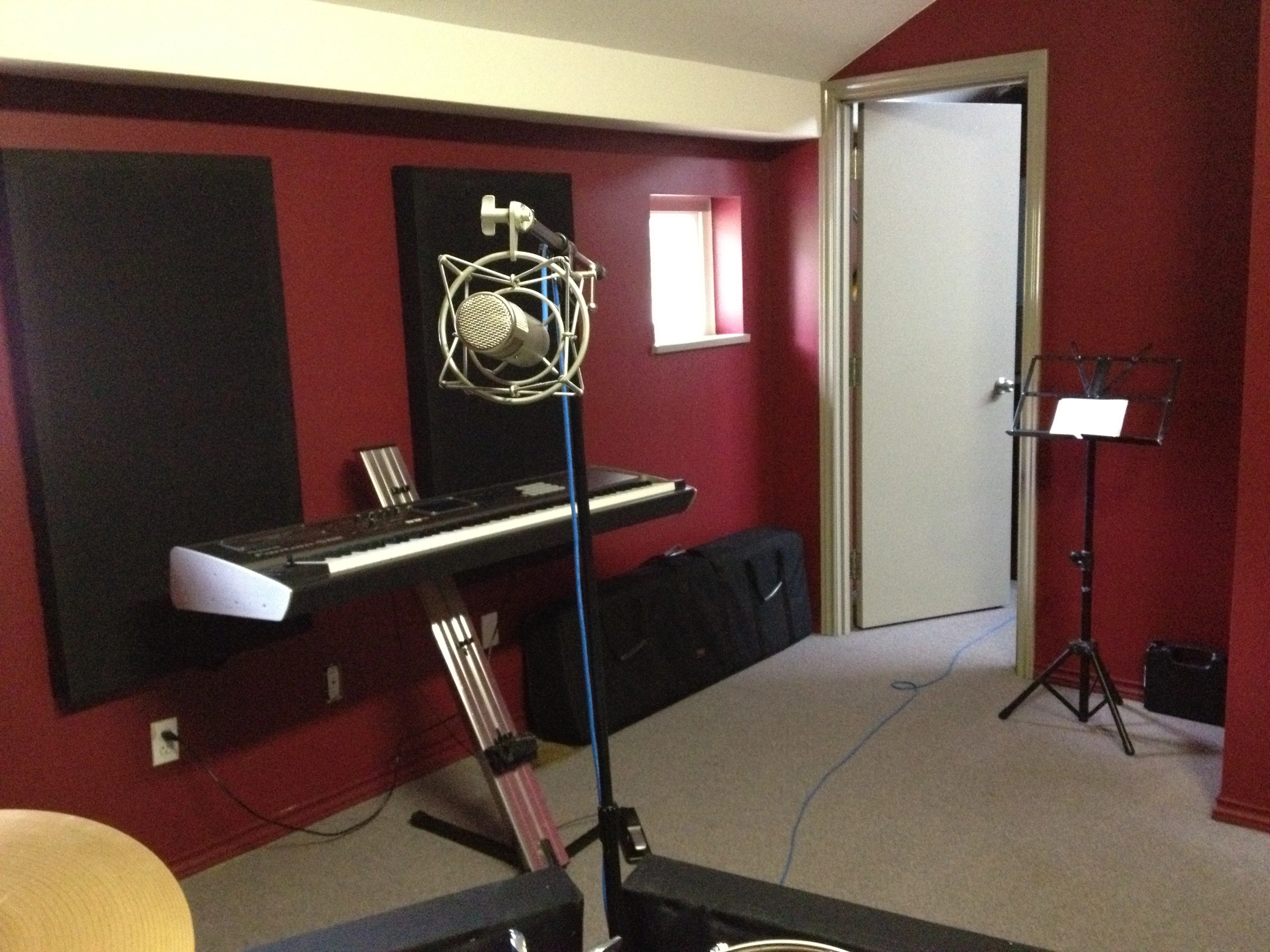

Great work! I would much rather work in a smaller cozy place than a huge studio. Love the color choice too. Watch the desk that close to the corner btw.

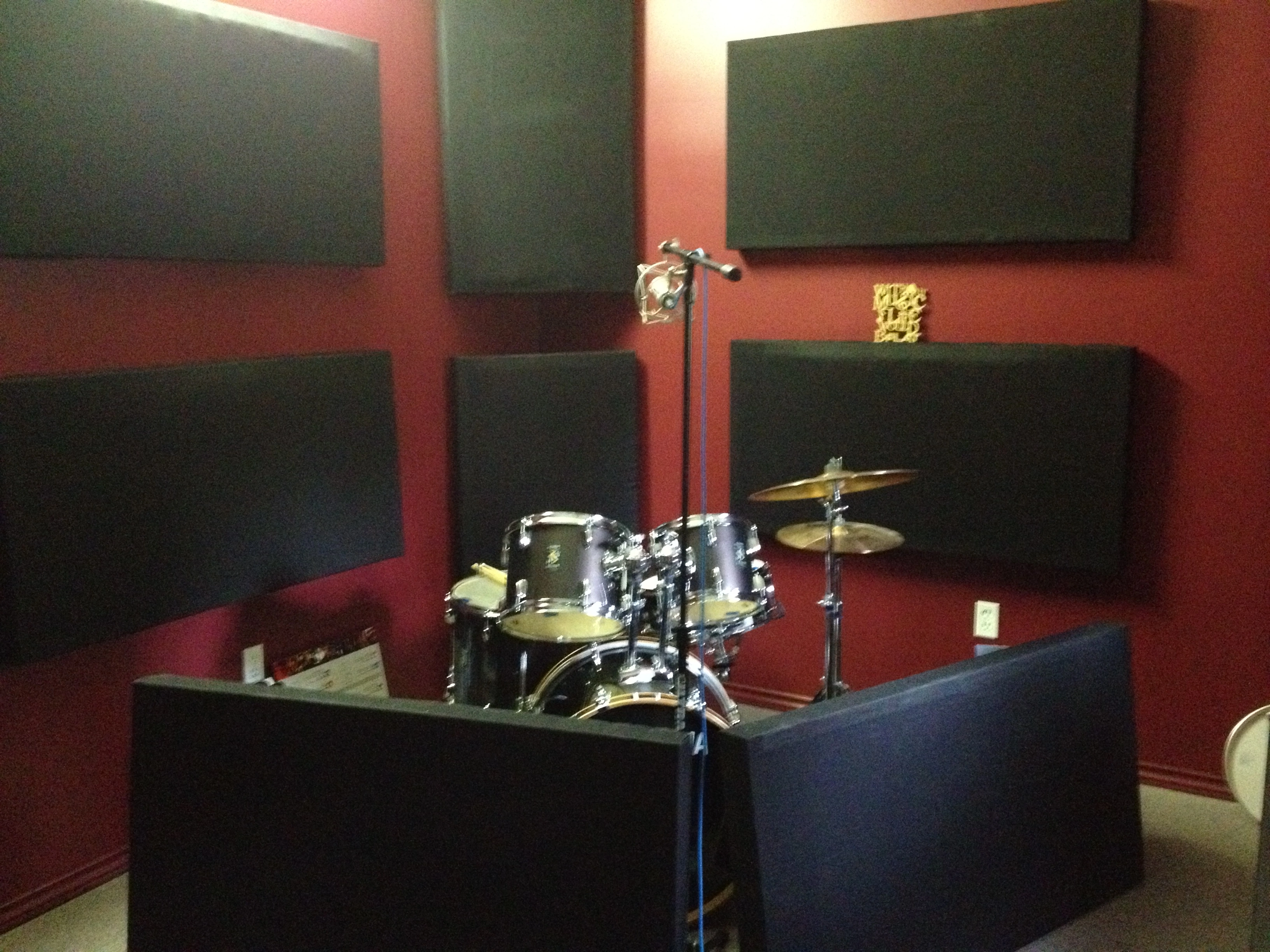

Wow, I had no idea! So when you say "thicker traps" or "at a depth of 6", are you referring to bass traps or just thick Broadband traps? Because I've heard that 6" of OC703 is the best way to go about a bass trap. So that's where I get confused...is 6" of safe n sound similar to just 2" of OC703? In which case a 6" roxul trap would just be really thick broadband?
I ask (and hijack) mainly because I'd like to make some movable baffles, maybe 6' tall and 3' wide. Using OC would be insanely expensive compared to roxul. Problem being, if the safe n sound is only going to be good at frequencies say above 500 hz for ex, I don't want to make the baffles out of that. I want the full spectrum (or lowest I can go anyways).
