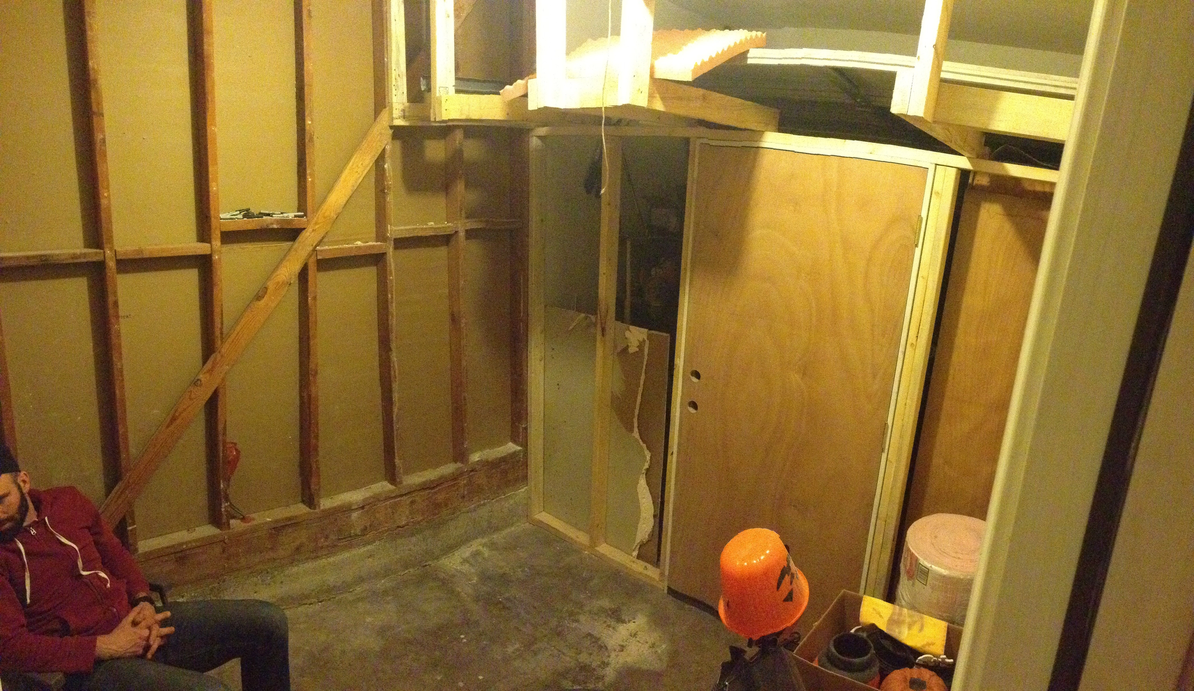

Hey guys, I'm in the process of building a small multipurpose room for recording drums, vocals, guitars, whatever, in my garage. I want it to be somewhat soundproof but understand that it won't be completely. The room is an odd shape but roughly 9x9x9. We have taken it down to the studs, insulating the walls and will be attaching 5/8 certainteed silentFX (which is two sheets of super heavy dense drywall with green glue manufactured in between)directly to the studs & ceiling. I considered the resilient channels but the guy at the building supply place said the silent FX would be fine on it's own. In addition to the silent FX we will be using green glue sealant to fill in gaps between the drywall before mudding, over screws and anything and everything else that may have an air gap. 3m fire putty pads over electrical boxes and inside the channel we will use for the snake/cables. Solid core birch door. And we will be building our own double pane window using 1/4" glass, also sealed with the green sealant. Finally I think we're going to get a 6pk of the producers choice blankets to put around walls/ceiling by the drums and doors and various other places for reflections. Haven't really considered bass traps but it is inevitable.
Anyways, just wanted to see what u guys think or have any advise. I haven't seen any reviews of people using silentFX in studios so I'll be posting some pics/vids as the project continues to help show/demonstrate the project and it's effectiveness.
Oh, and we are going to need some airflow. I'm going to have to tap into the line from the room next to it which I understand will compromise the soundproofing element, any tips on that?
