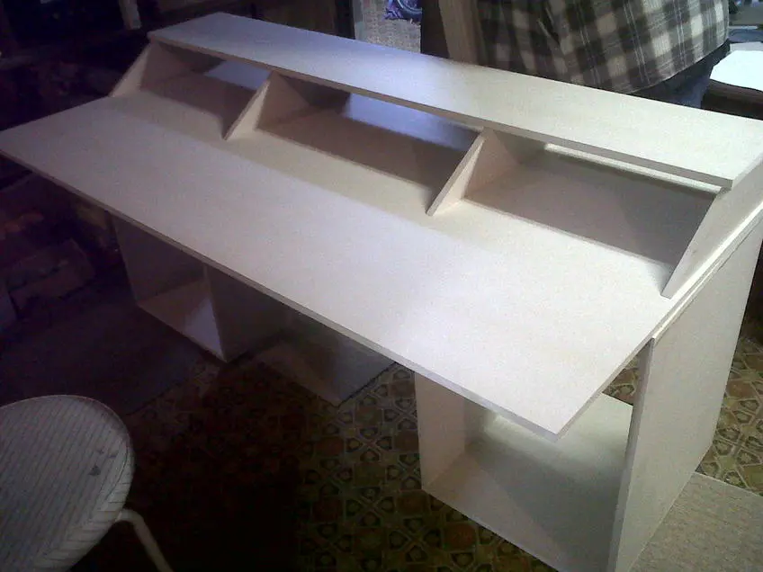

I'm building a workstation for my music room at home.
I sold my old one to a mastering engineer.
So I came up with a new design.
I'll post more pictures as the build progresses!
What do you think?

very nice! What type of wood are you using and how wide is it?

I build out of 3/4" MDF. It's 73" Wide by 35" Deep.
I find, finishing (spraying and clear coating) is my favorite part of the building process!
I put on a laminate called formica and then a neoprene filled leather arm rest.
Then I finish it with wood trim on the sides.

You got it. I had a lot of people want a desk with a continuous shelf so to put dual monitors and that would fit speakers.
On the bottom, I'm adding doors, so a computer will fit in and you can access the backs of the racked gear from the front as well.
I think it'll be the best one I've done so far!

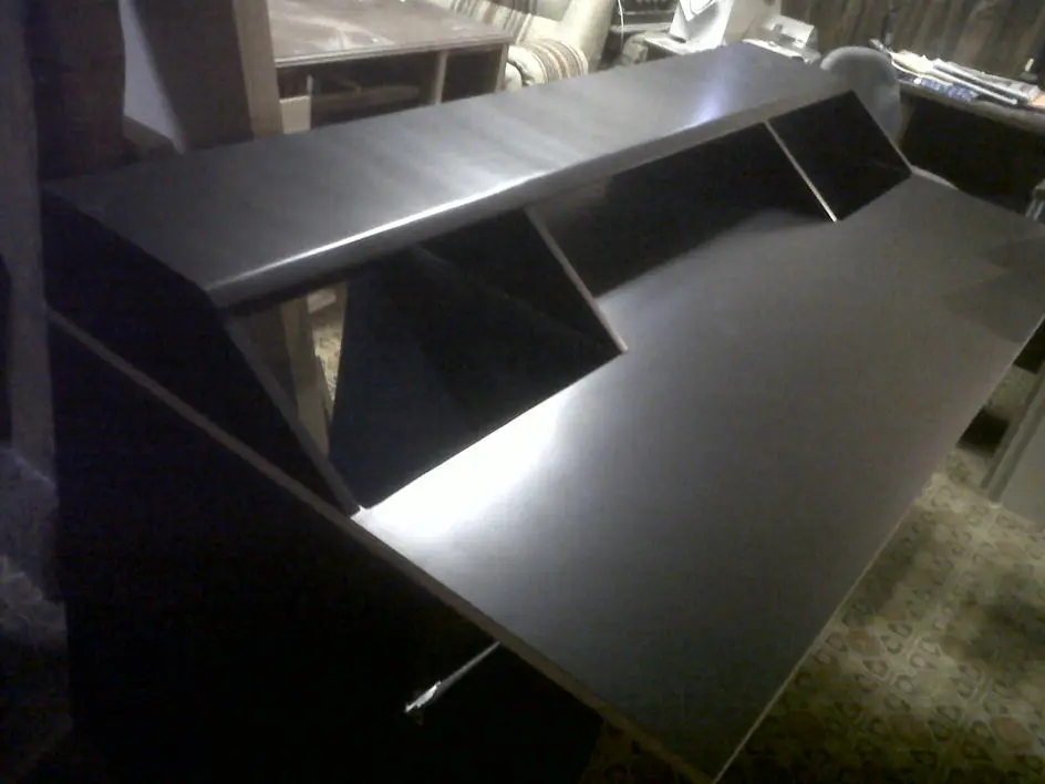

Well, the last couple of days have been spraying and finishing and I haven't really taken pictures.
I'll take a few more pictures over the next couple of days and the finished product!
Cheers.

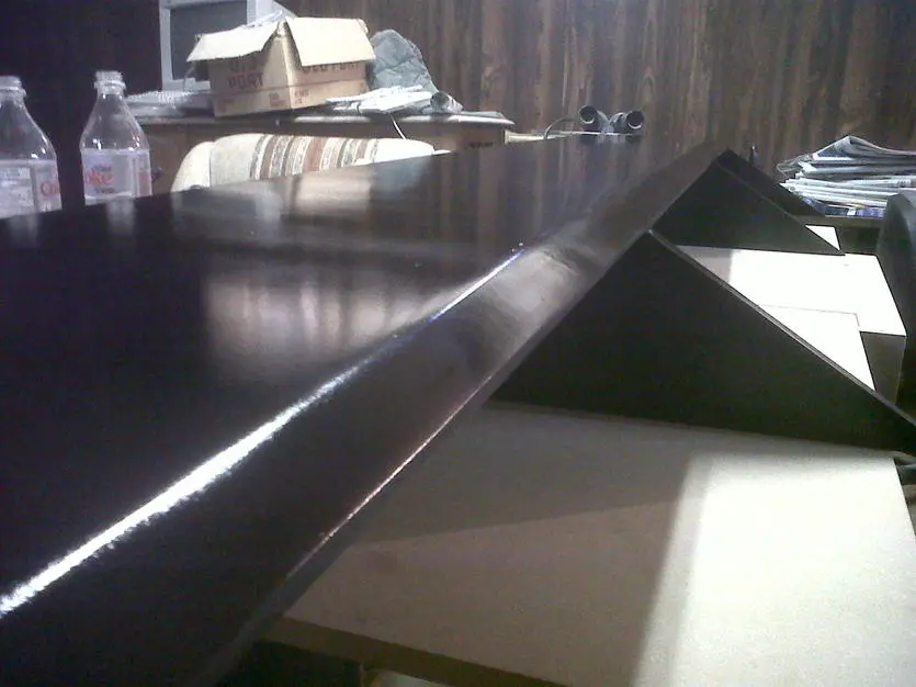

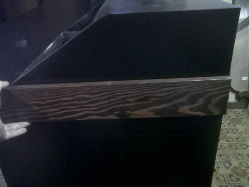

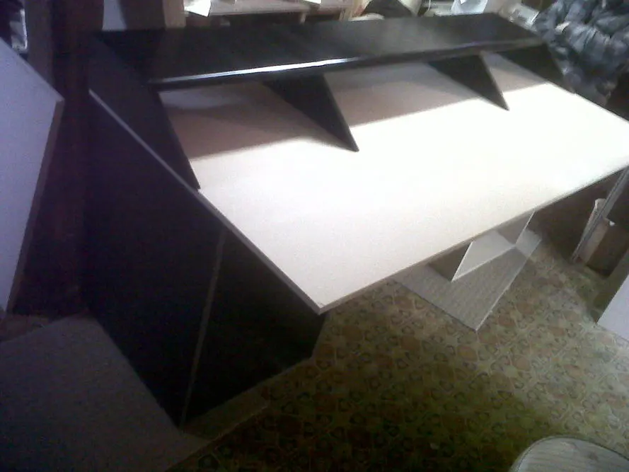

Got the laminate on. and stained and clear coated the wood trim!
Just have to mount the wood trim and the rack rails. Also do the arm rest. Should be done by wednesday!

Yup, that is your signature end piece mark. Simply amazing sir, simply amazing. Great job.
