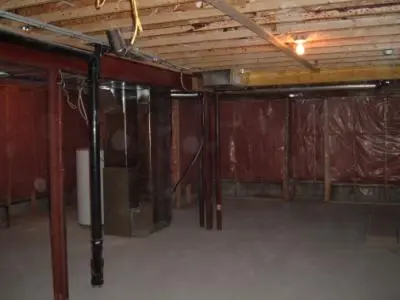

Picture 1) Facing South
This picture shows the future location of the studio. The view would be if I were to be sitting at my mixer and did a 180. The studio will be build along the wall. It will only go to the second window as per my diagram with the control room being on the other side. That is phase 2 of contruction.

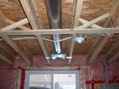

Picture 2) Duct
This is the vent that will be running right over top of my mixer as per my diagram. Whats the best way to isolate this? I have another vent exactly the same down by the other window. So, in total,

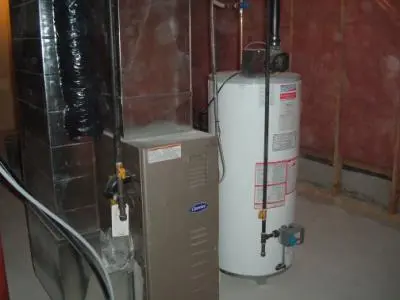

Picture 3) The Beast
This is the HVAC system I will be looking to soundproof. Its not in the studio but I will be framing around this for isolation. The furnace is a Carrier Infitity 97, and it is QUIET.

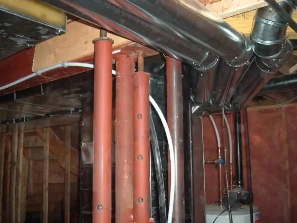

Picture 4) Structuralsupports
This is outside the studio as well and will be framed in. Any ideas or tips here would be greatly appreciated.

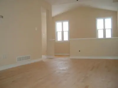

Picture 5) Upstairs LiveROom
Well this will be a dining room, but when need be I can record whatever I want in here. You can see the 4" conduit tubing in the half wall (The hole in the wall). That leads to the studio below.

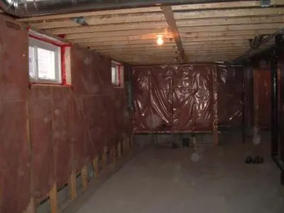

Pic 1 ) Facing North.
This is at the far end of the studio looking at the mixer. If I were to walk to my right a few steps this picture would be taken from the floating floor section.

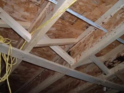

Pic 2 ) Ceiling 2
Just a shot of what I am up against as far as working with my ceiling.

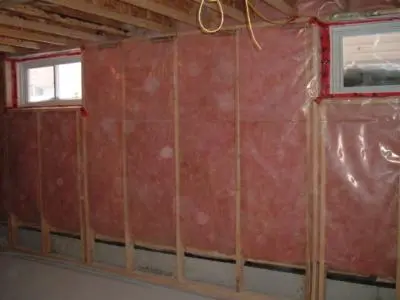

Pic 3 ) East Wall
Pretty self explanatory, this is the eastern wall of the studio
Pic 4 Facing south
Another shot from the mixer. This looks down the length of the studio. Eventually the studio will go right to the end of the basement
