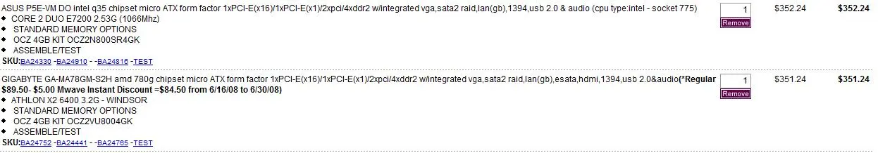

The Intel motherboard is more expensive, with less functionality. Thus I am pulling money away from the processor and kicking it to the mobo. The memory on the Intel mobo is also a little bit... just a little... less memory than is on the AMD board.
So the question is simply this... will a Intel CORE 2 DUO E7200 2.53G (1066Mhz) outperform a AMD Athlon X2 6400 3.2G? If the answer is yes, get the Intel, if no, go with AMD.

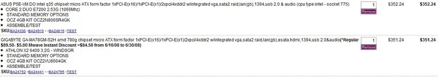

Not too sure what I am looking at there. Here are the two mobos side by side. Note that the price includes the mobo, processor, and memory. Also note that I am not a fanatic for AMD (or Intel)... just the best perceived value. And to that end my perception is that the AMD board offers more bang for the buck.
