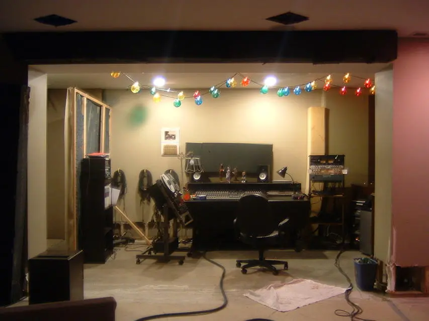

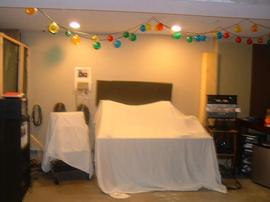

Before........

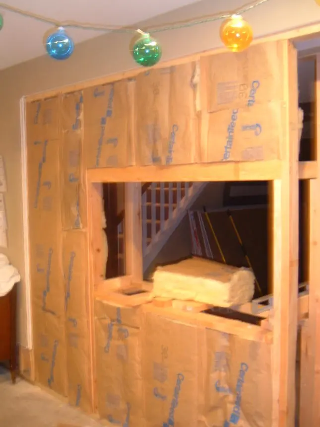

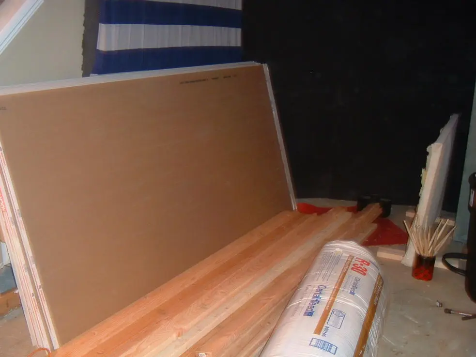

After Day 1.....
My first question is...How does an 18 year old get his hands on that much equipment? Your mom must be pretty generous. (Just kidding, that's your business.) Is that you in the last pic? Gees, you don't look a day over 17.
Looking good so far. Isolation from the rest of the house and neighbors is the hardest part. Noise travels right through the lumber of the home. Especially bass.
And outside too. Just yesterday a guitar player was here recording rhythm parts. His amp was set to maybe 8 on a 10 scale. I walked outside while he played and could hear it clear as a bell down at the mailbox. I need to build a new wall in front of the window in my live room.
Anyway, keep the pictures coming. We enjoy them. And some of us learn from them.
PS. Are they NS10's in that first pic?
Nice pics. I hate to be nosy but what kind of reel is that. Looks very nice. At first I thought it was a Teac x1000-r but the tape width looks to be 1/2 instead of 1/4. Keep the picks coming.
Doesn't look like 1/2 either. I'm goin" nuts.
Hahaha she's the tascam MSR 24. 1" 24 track. absolutely love it!

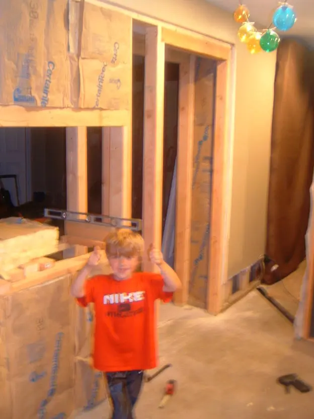

Lucky for me we just had an addition put on our house and the isolation from the outside is very good. I had to test to see if you could hear a drum kit from my neighbors house. Nothing! Haha the kid is my little brother he loves helping me out when I have my crazy antics in the basement. The speakers are the HS 50's I don't have the balls to mix on NS 10!!

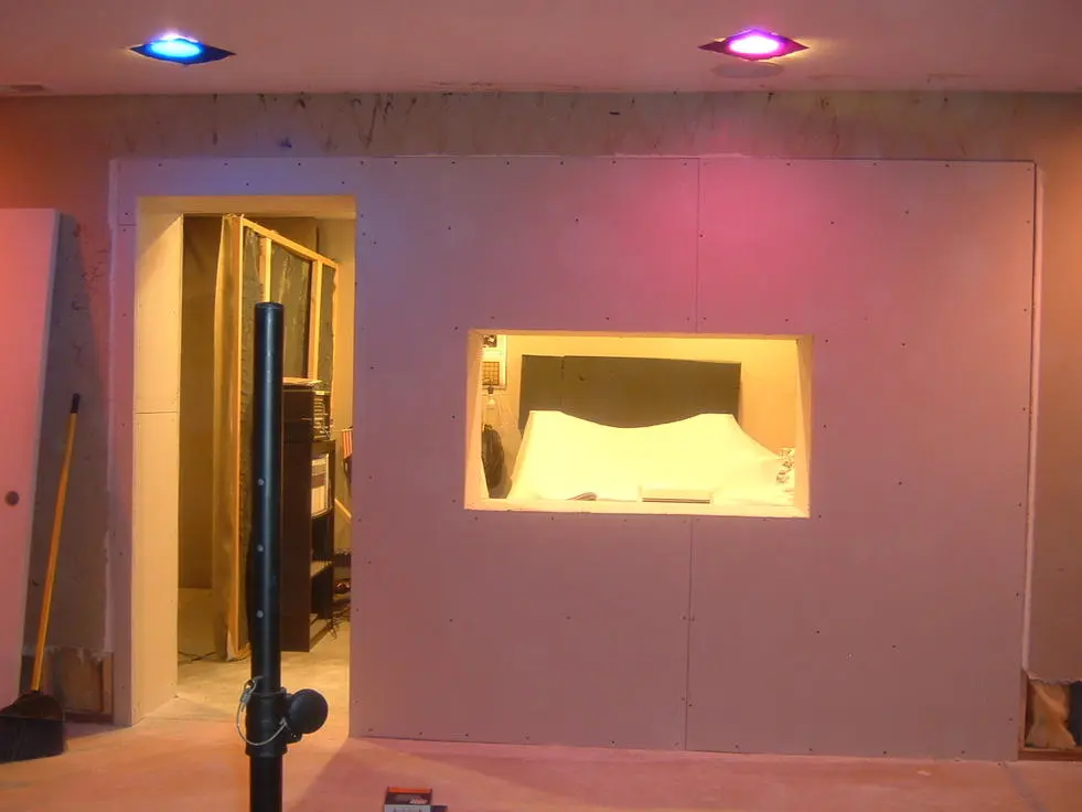

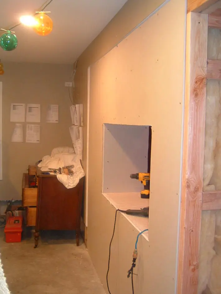

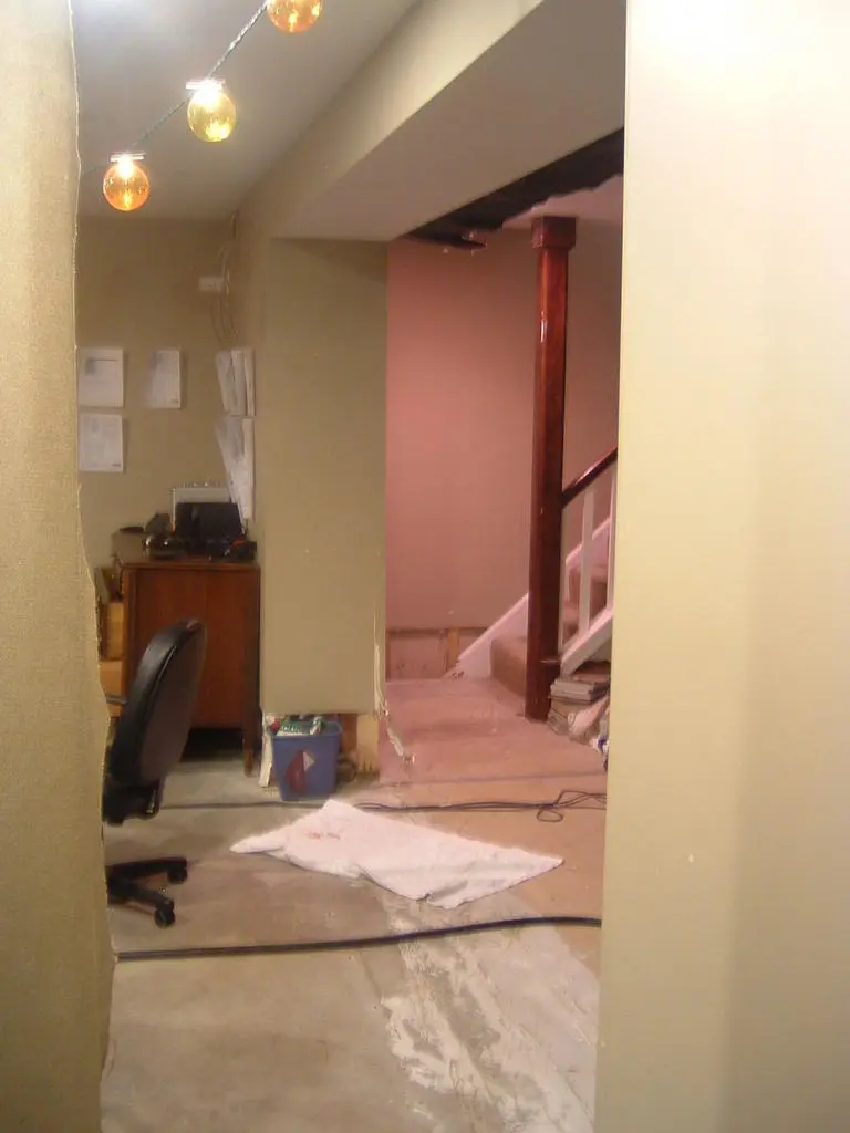

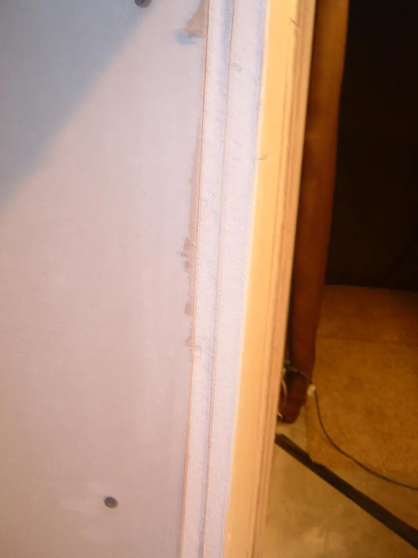

Day Two, Dry Wall. The bulk of it is out of the way. Now just for the hard stuff, window and doors....
I went with a 4 leaf assembly and put 2 layers of drywall on the outside of the studs. I hope this is gonna get me the iso I need! It's a toss up at this point, I really have no clue how it's going to turn out.
I just ordered 2 panes of 1/2" laminate glass from a friend who is a glass distributor for very cheap. Just gotta work on getting the magnetic weather stripping and trunk rubber for the doors. I'm gonna hang two doors with about 15" between them. Each door is about 150 lbs no kidding. I've got plenty of mass on my hands here so I'm thinking I might be able to actually do this! Hahah.
I've run into a problem. Getting my cables through the wall... I made a "tunnel" for them in the wall outta just scrap 2 x 4s but I'm sure that needs to be sealed off somehow....I was thinking of putting the cables through, framing it with drywall, and then caulking it? But I dunno if I want my cables in there that permanently and also I'm always adding gear to my racks....

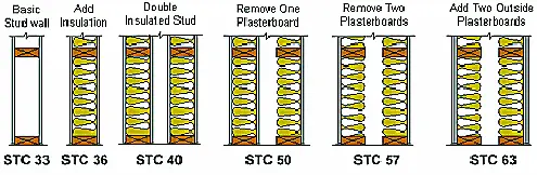

You can't be serious?! A 4 leaf system is terrible! Removing the two inner leafs will significantly INCREASE isolation!
Pandamonk is dead on as far as 4 leaves are concerned. Hindsight is 20/20 but the info has been here for at least 6 years that I know of. However, he might be wrong because of this:
If you mean you built a DOUBLE wall, with ONE leaf of 2 layers of drywall on the outside face of each wall, then you do NOT have four leaves, you only have two..which is good. However, if you mean you drywalled BOTH faces of each of the double wall frames...then indeed you have a 4 leaf system..not good.
It never ceases to amaze me how many people come here AFTER they build iso assemblies that DON'T do what they thought they would do.
Although, you may have flanking paths that could undermine the BEST Transmission Loss you could build in a wall. Like a coupled floor, common ducts, common exterior walls etc. All must work together or you have the dreaded weak link syndrome...which if this is any indication...
then doing this may be a waste of mass, time and money...
...especially if you just built a 4 leaf wall system to put them in...ie..why put in a double door system with a possible TL rating of 52 if your wall system is a weak link with a TL rating of 43 or your window sytem TL only reaches 39?(hypothetical TL ratings)

Hi Pandamonk. Well, John Sayers builds these kind of assemblies all the time. Its called an INSIDE OUT wall. Its STILL two leaves with the studs on the outside of one wall. This allows for insulation in the exposed side to be used as absorption...but I'd suggest using 703 or Rockwool vs standard batt insulation.
