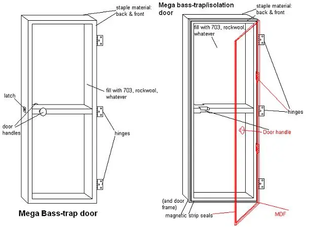

At the bit where you say "door will be placed here" you could install one of my designs. If you do not need isolation, and are only looking for (bass)absorbtion then you could do the "Mega Bass-trap" idea. If you need isolation, but also want a bass trap, you could do the "Mega bass-trap/isolation" idea, which gives you the option of using the staircase as a mega bass trap, or having a good isolation door. What i have not shown in the picture attatched, is that you would install an MDF door on both sides(on the other make it go the other way, because the banister, and put 2 handles, one to open the isolation door and one to open and shut the whole door), to give a mass-air(insulation)-mass setup. You will want to use magnets as it gives a good seal and holds the door in place with no need for a latch. You will need someone to open the isolation door on the stair-side (can't think of any way round this, unless you build some kind of mechanical system) Hope this helps :D

If you install the door basstrap, it should be fine. Knightfly said before, when i suggested it, that it'd be like having an open window, except without the sound leakage. The person i suggested it to had a 12' room on the other side of the door and knightfly said they'd get peak absorbtion at 23Hz. It doesn't look like the stairsway is 12' deep but it will certainly be deep enough. And yes you want symmetry, but for bass absorbtion it shouldn't matter. It's very difficult to tell what direction bass frequencies are coming from. I think having it in the door will save space/work. What do you think bpape?
here is what knightfly said
knightfly said:
If you were to place thick rockwool (like 6" or more) in place of your non-existent "door" between rooms, then you should indeed get a giant bass trap effect; with a 12 foot deep room behind the rockwool, it would peak in absorption at around 23 hZ; but it would also absorb below that, and pretty much everything ABOVE that as well. IOW, it would act about the same as having a large, open window there that everything can pass through, never to be heard again. (this would not be a bad thing)
aha, got it. Worked out how you can close the isolation door without getting someone else. Don't build it onto the bass-trap door, build it onto the wall. So you close the isolation door then the basstrap door, and vice versa when going out.
This was briefly mentioned, but I don't think covered very well: once you've got the door in there, is it going to be possible to move your monitors out of the corner? It's best to have your monitors equidistant from the left and right wall.

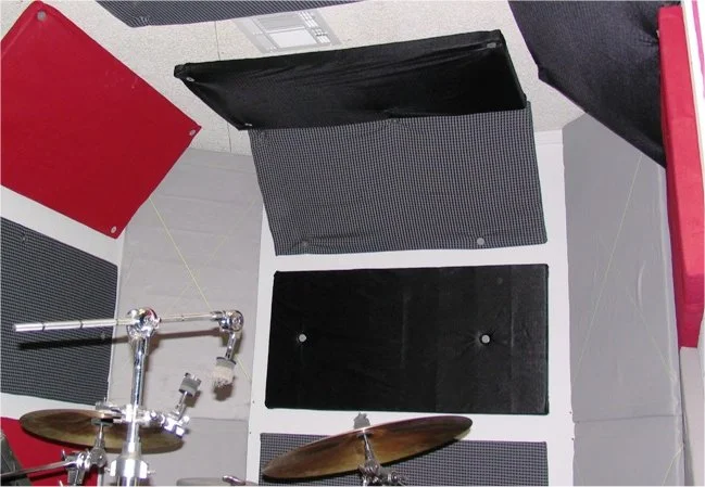

Keep in mind that these panels don't need to be framed if you are just making "absorption panels" to hang on the wall. If you are making sealed bass traps... then that's a different story.
When we converted my drummer's garage into a studio/rehearsal space, we made about 40 panels. It would've been expensive and very time consuming to frame them. Instead, we just used iron-on adhesive and wrapped them in fabric like Christmas presents. Then we slapped them on the walls and ceilings with 3" screws and fender washers-- don't even need to hit a stud.
The drummer said he didn't care how it looked and it's his house so I didn't argue. So we just slapped them up without worrying about aesthetics.
Just something to keep in mind...
pandamonk said:
Looks good. How does it sound?
Well... I have to assume the "looks good" part was a healthy dose of sarcasm... lol! :D Because even I don't think it "looks good" and I was a co-designer/co-builder.
But it sounds great. People who know nothing about acoustic treatment, etc. walk into that room and comment on how it "sounds like a studio" in there. When you walk into that room you can hear the difference immediately. I don't know how else to describe it other than those panels seem to "suck" the sound out of the air. You can see in the picture how we've got 4" panels straddling the corners... that's the only bass trapping we've got. I'm sure we could use some more low-end absorption.
We used to practice in that garage when it was untreated and the difference is dramatic.
The only reason I mentioned symmetry is because these will not be JUST bass absorbers but will be broadband. He doesn't really have any good way to sit things so that he can do 2 vertical corners. With the ceiling junction, he can potentially do all 4 and not worry about it.
I have no problem with the door thing if you can either make it bass only via a facing of some sort OR do the same thing symmetrically on the other side in appros the same place.
