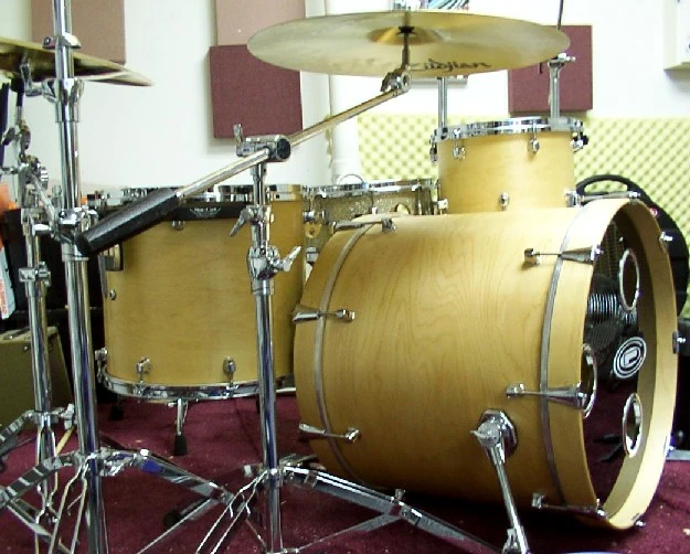

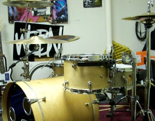

I have built my own set. It looks great. Sounds better than a kit costing twice as much. I bought the shells from precisiondrum.com. I'll post some pics if i get a chance.

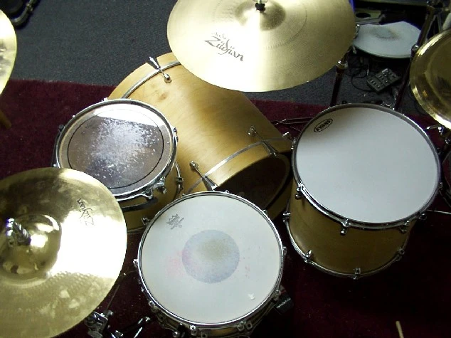

pic3:
Some notes on the kit:
-18x22 kick 10 ply
-8x12 tom 8 ply
-14x16 tom 8 ply
All shells are maple ordered from www.precisiondrum.com. The lugs are Mapex lugs. Both toms are floating via Tama starclassic mounts--die cast. The lugs are 50% offset.
the snare is ocdp.
