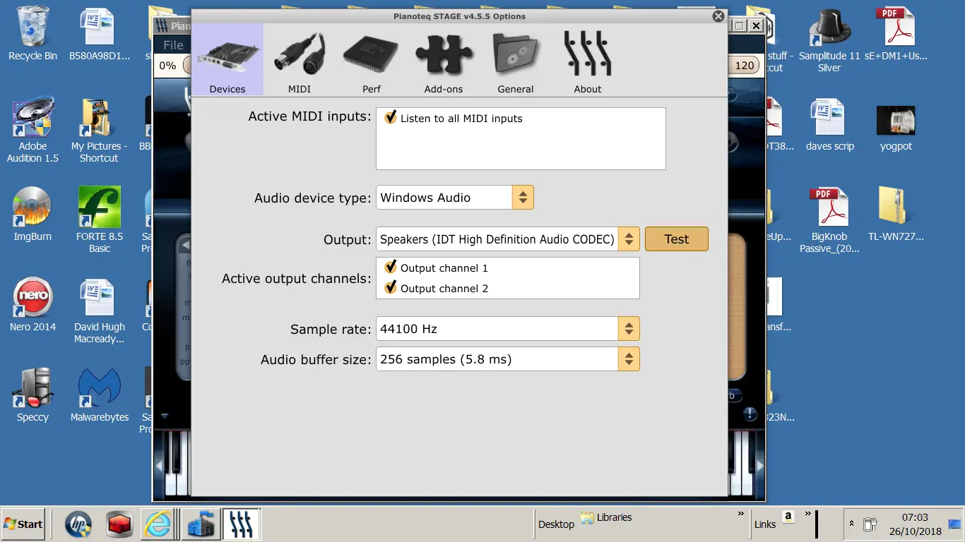

I don't have anything like your setup (G'son has my MIDI kbd) but I fired up Modartt's Pianoteq, see attached.
This 6ish year old i3 HP laptop gave me virtually instant playback from the screen kbd and excellent sound quality from the driver and buffer setting shown.
I suggest you install the demo of Pianoteq as that should prove the system out.
