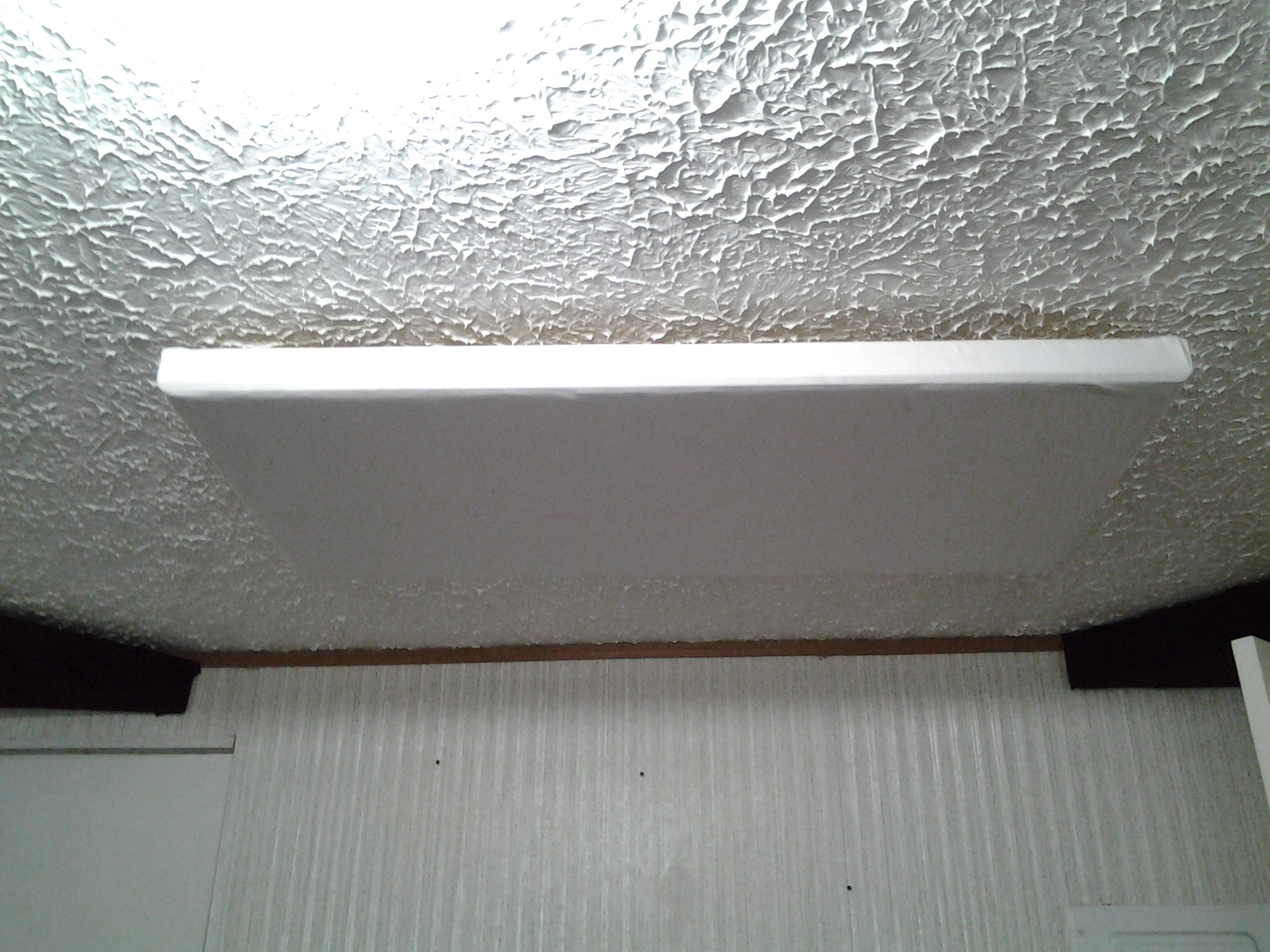

Second ceiling cloud (at back of listening area.)

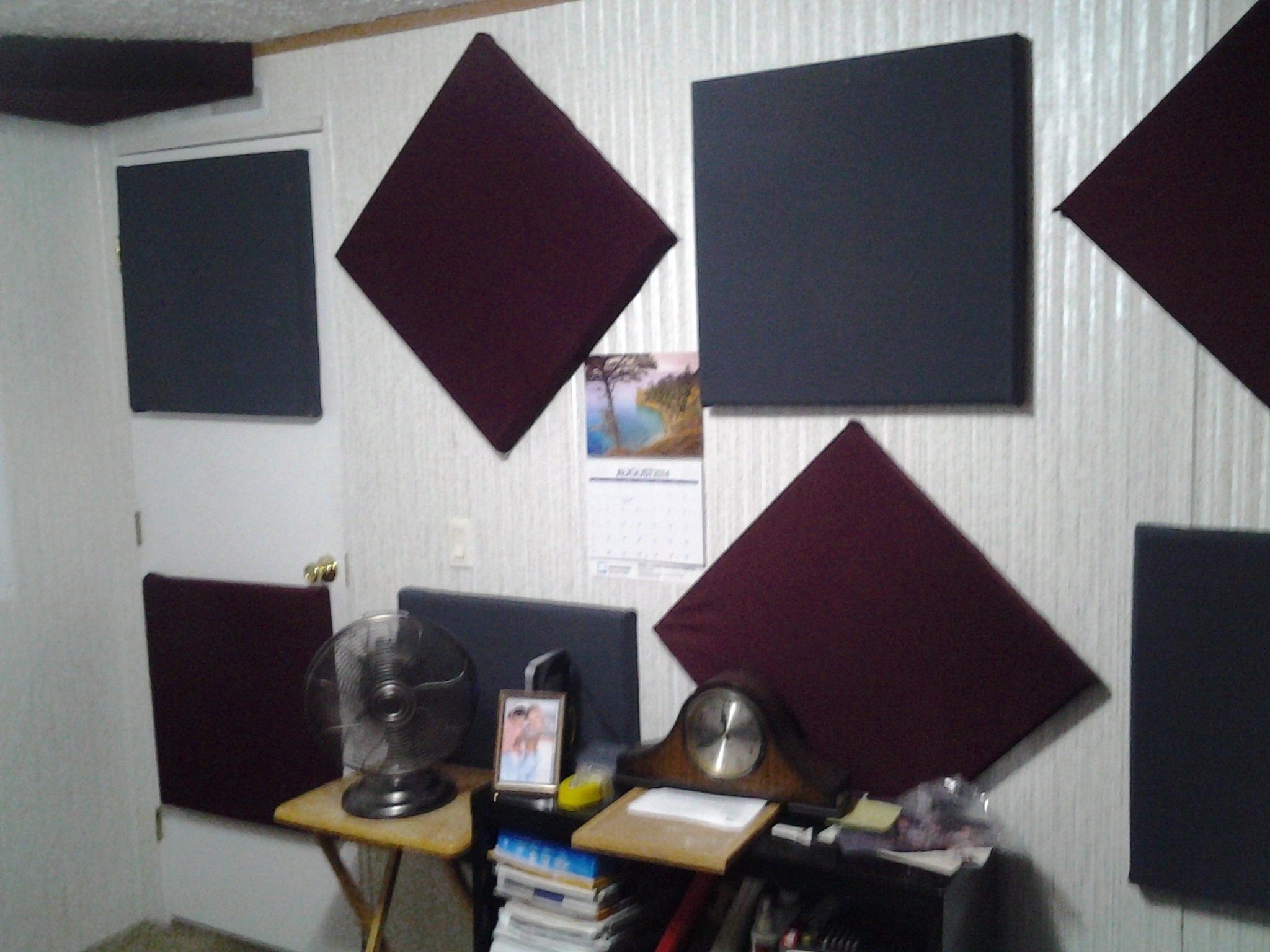

New bass traps in the corners. (I will be making some super chunk for the bottom and placing the new ones on top, leaving the foam to come out from the corners, or cloud in the center of the long walls, depending on what frequencies they affect where).

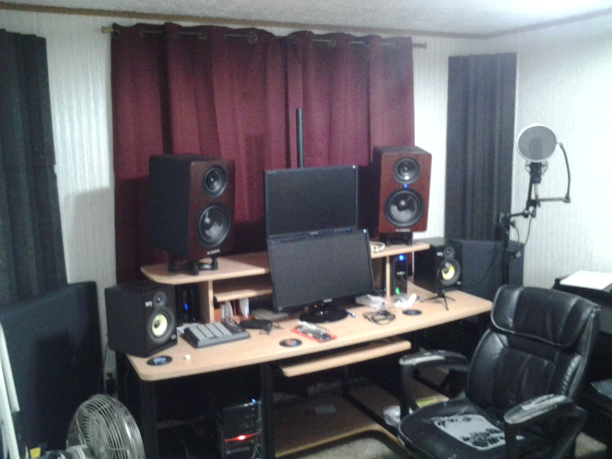

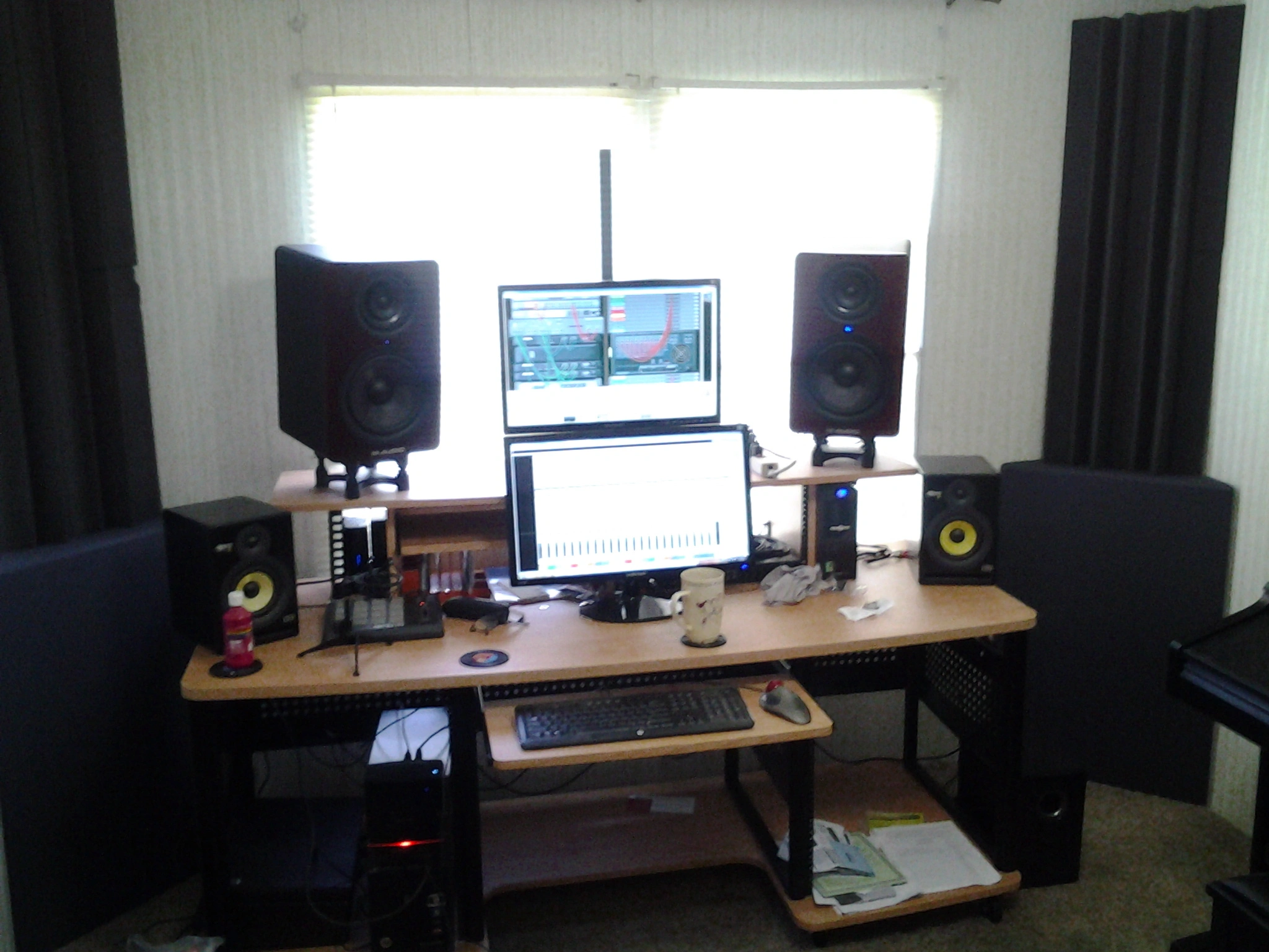

Where did you get that desk? I really like it and I'm going to be in the market for one at some point (maybe soon).
Very awesome desk. Lots of rack mount space (both sides on the bottom, and right side on the top). Lots of space for everything I want. Eventually want to move it away from the wall about another foot, and use the Rokit's as near field and get the M-Audio's on the wall by the traps (got to finish the traps first...
Anyway you can find what I bought at this link. $500 with free shipping, but had to pay tax.

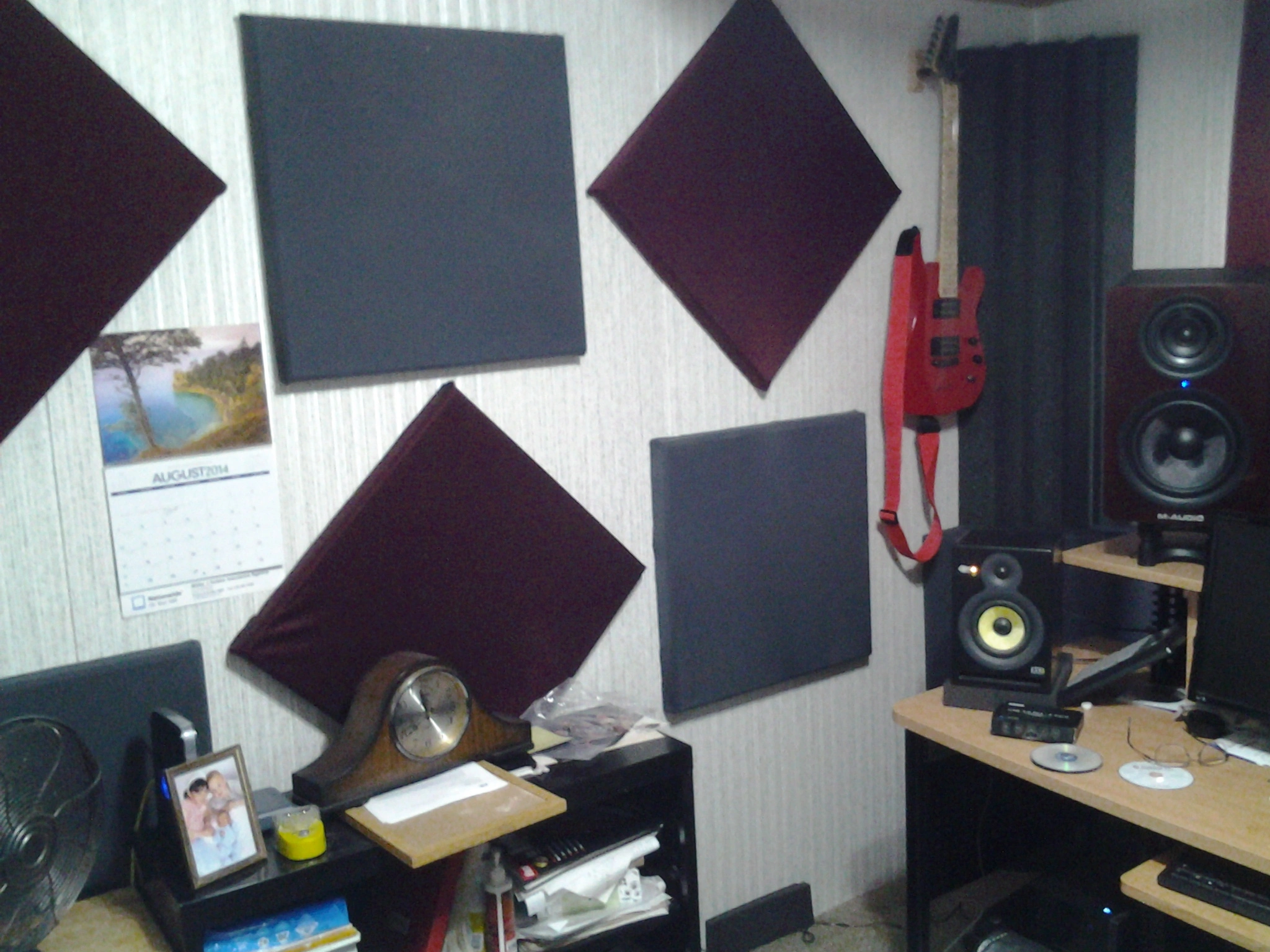

More stuff in.
More stuff out! :D

Was a little disappointed with one of the corners on the burgundy diamonds puckering up after I mounted, but I'm using 0 spacing with silicon behind, so removing would mean a big clean up and reapply of the silicon. Nah! It's enough work getting them up once. Won't change the sound.
New desk required isolation from the Rokits, so I got some cheap Mopads. They work remarkably well.

How'd you hang the cloud? Pics pretty please of the mounting?
I had the Fiberglas anchors and used 6 per panel. Talk about fun to hang! Wish I'd of thought of zip ties. Used J-hooks, used the wife's nail polish on the top of the anchors and pressed that carefully against the ceiling to locate the pilot holes. Then it was just a matter of patience getting all 6 lined up at once and sliding. Fiberglass anchors are fine and all, but if you wanted a straight line for easy mounting, just forget about that completely :eek: There's absolutely no way of knowing where they'll end up when you start winding them in.

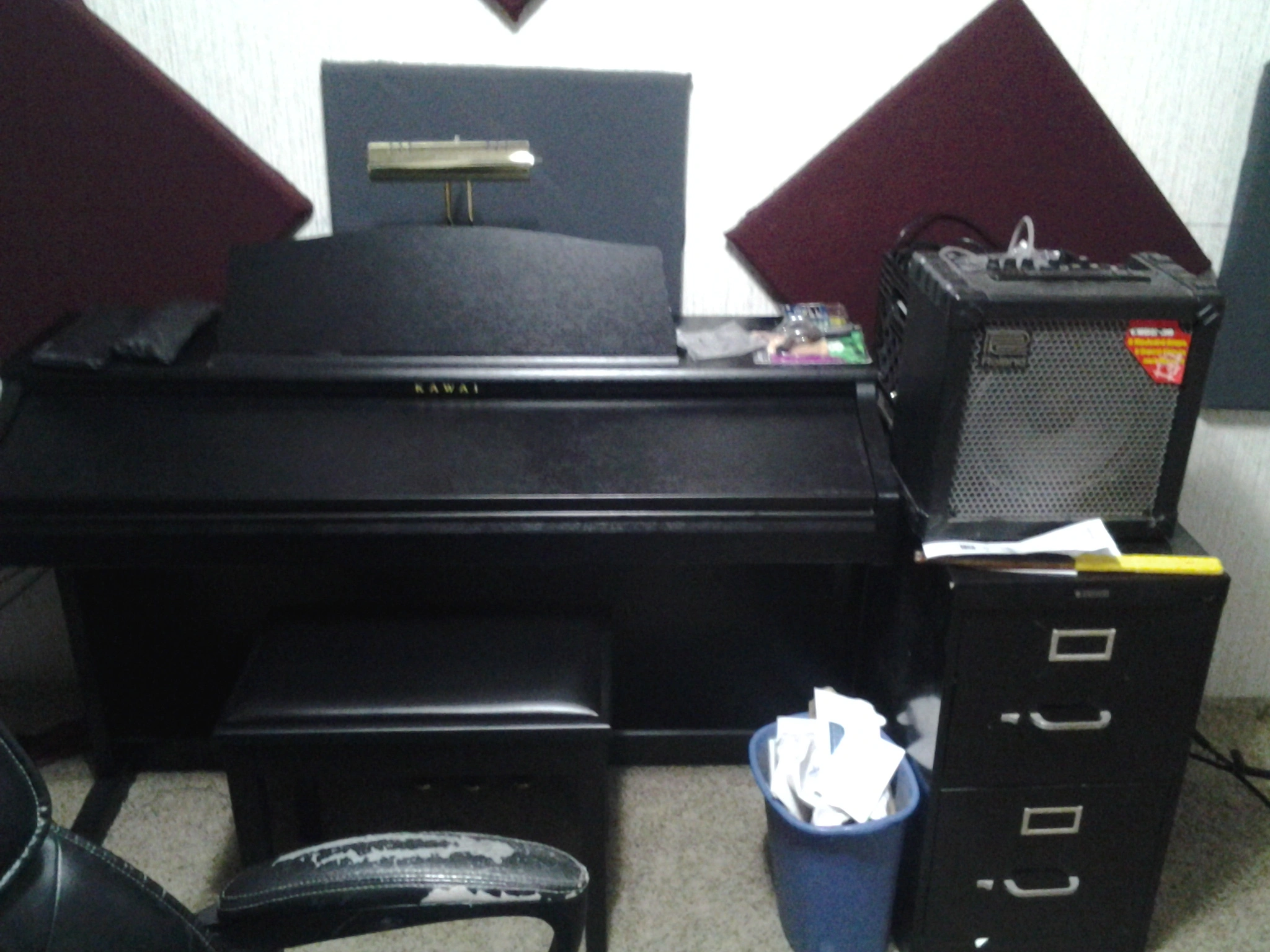

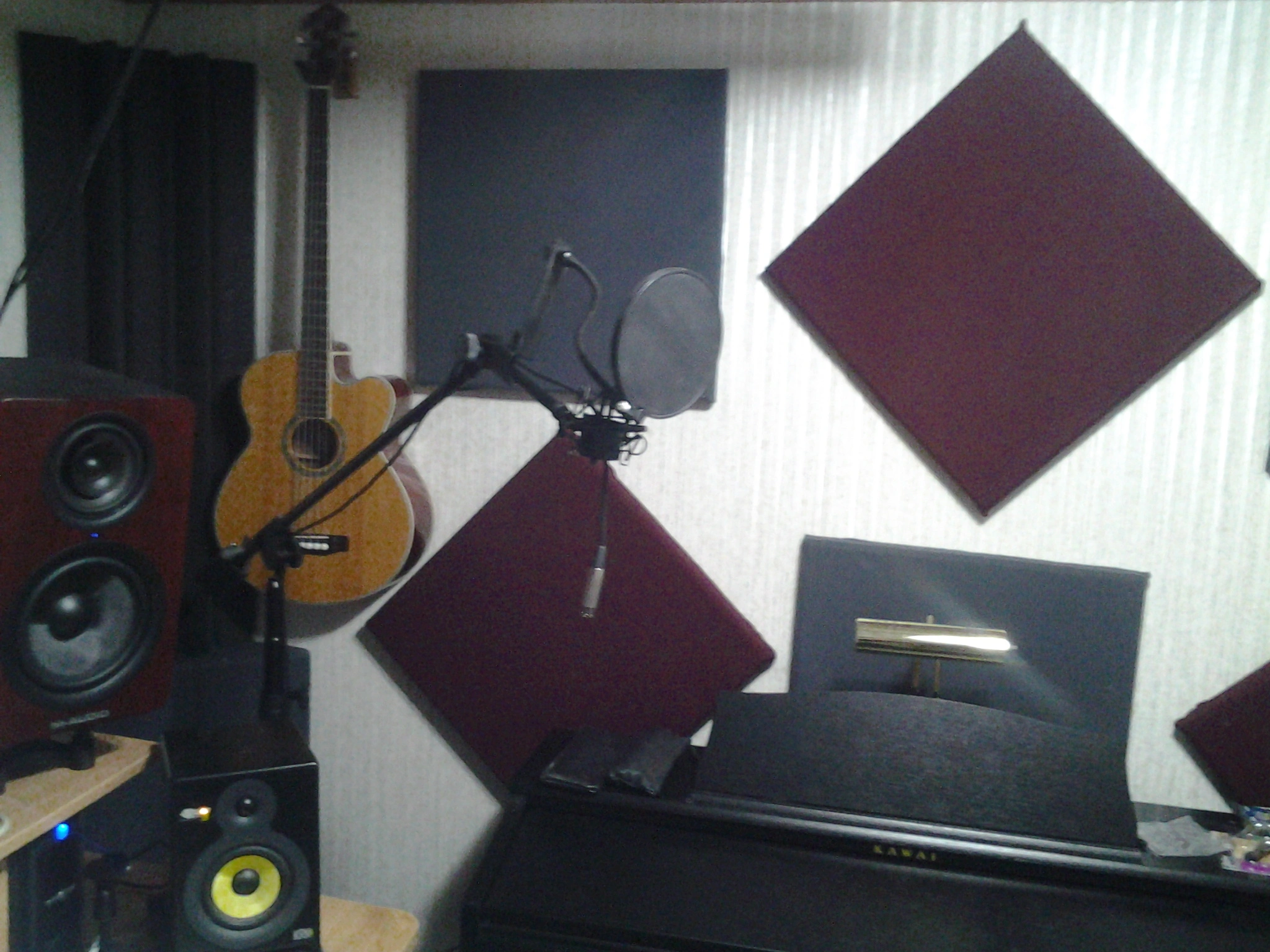

Well, the third wall is done, and the back wall (the most important) is yet to go. Going to take some time to make sure it's right. Want to build some diffusers for the problem frequencies in the room and go from there.
My trash can is full! :eek:
The wires you see hanging down are my midi cables for the drums. Ran them above the clouds. :D Worked perfectly.
