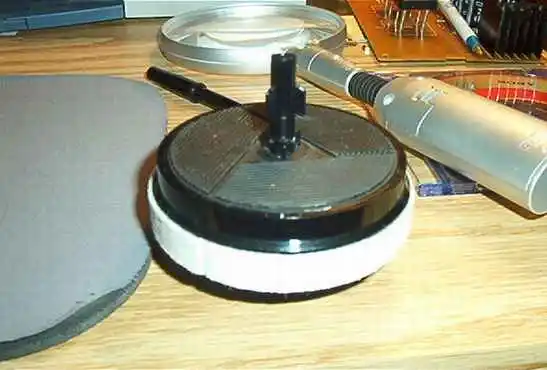

Do you mean this part?
The same thing happend to me with my 388. You need a new reel table. Call Tascam, I think it was around $50.00. In the mean time you could use velcro tape to keep the reel secured to the reel table, but you'll have to lower the reel table a tad to make up for the height that the velcro adds so the tape doesn't rub.
yep,that's the part. just the bottom has snapped. i live in the uk, will i still be able to get parts form tascam?
