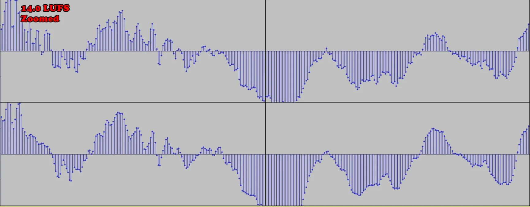

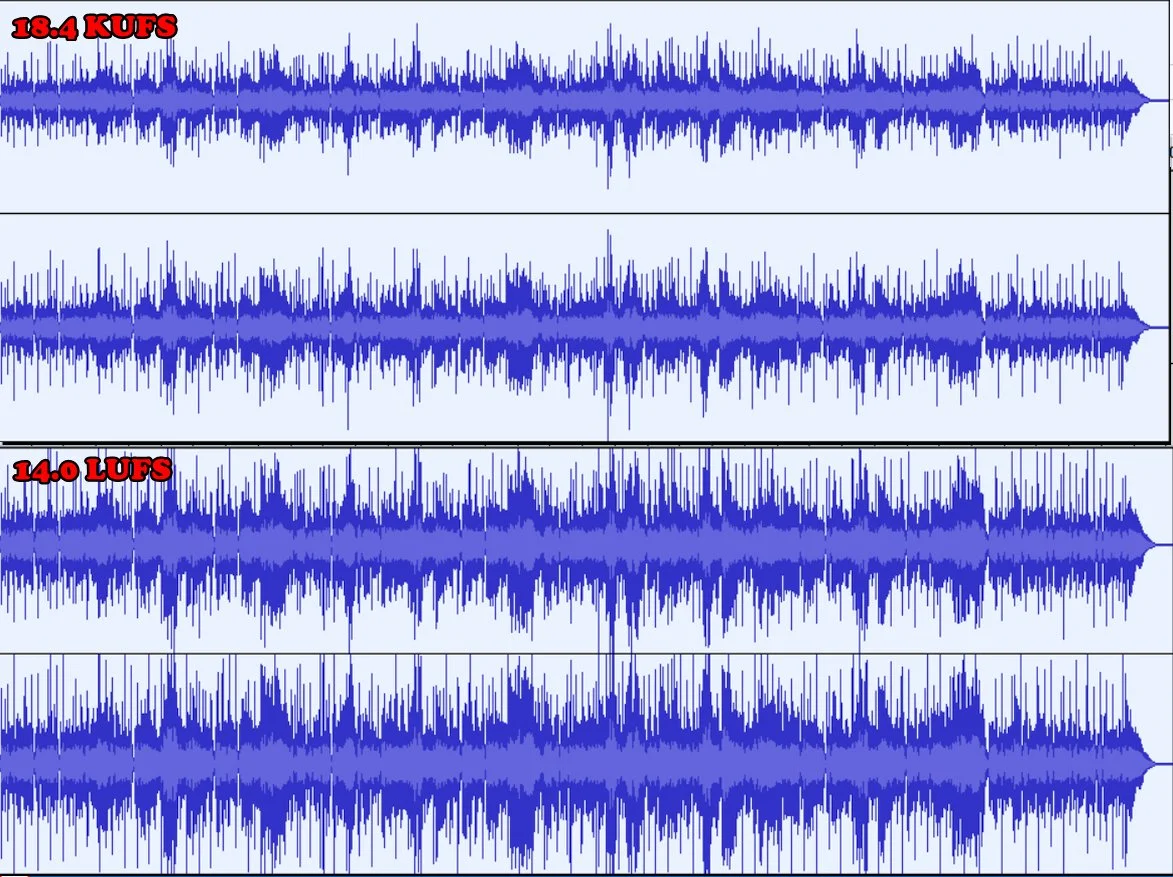

Above, I mentioned that you need to look at what the program/plug-in is doing. Here's an example. I took one of my tracks that measures -18.5LUFS with a max peak of 0.05dBFS which is just past half way. I plugged the file into Audacity, and use the Loudness Normalization function, set the value at -14LUFS. Here are the results.
Clearly you can see that the program didn't use any compression or limiting in the process, just calculated how much it needed to increase the volume and cranked up the gain until it got a -14.0LUFS. Consequently, there are lots of peaks that are completely flat topped.

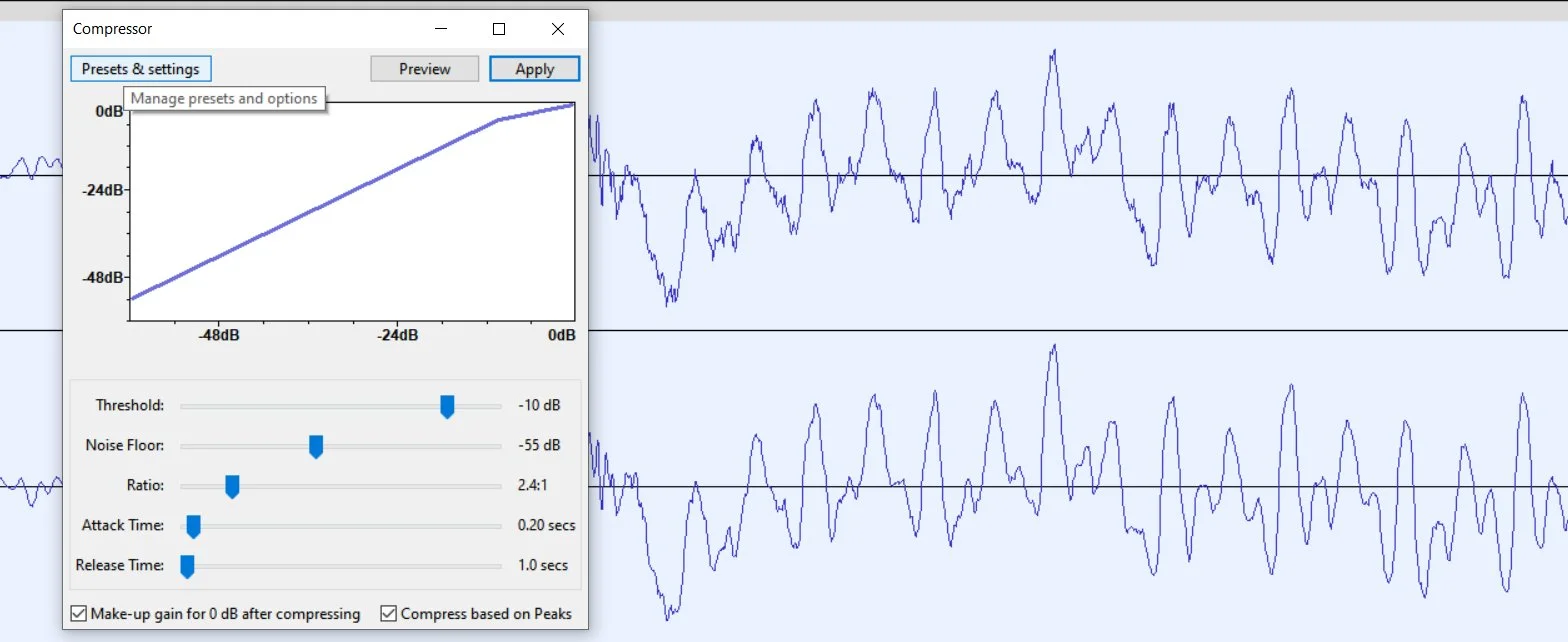

A better sounding process was to put a compressor on with a compression of a 2.4 on peaks above -10dB, and use make up gain. This gave me a LUFS of -14.2, sounds as loud as the Loudness Norm function but there are spots where it's not quite as spitty sounding, especially on snare hits. This is the same section, you can see that there are no flat topped peaks. It does have a bit more compressed sound vs the original, but it is sounds a bunch louder.
So it's important to know what the process is doing to the file.

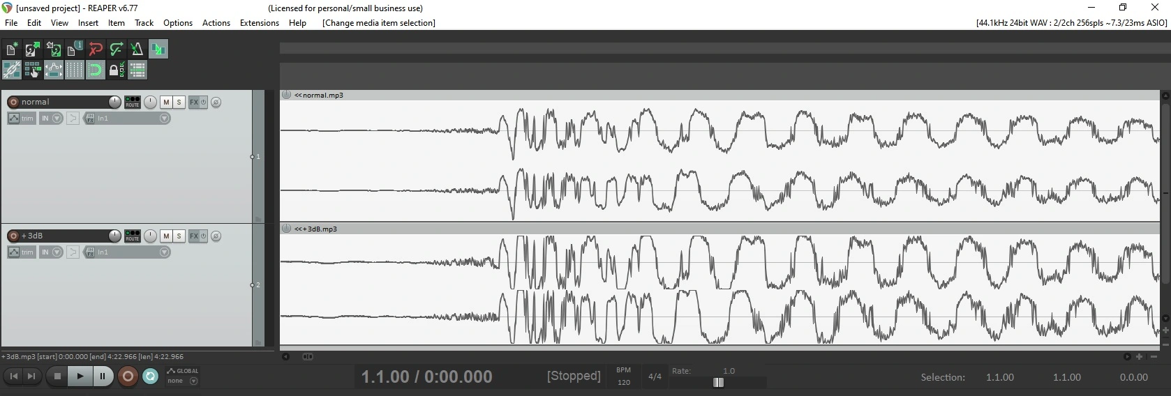

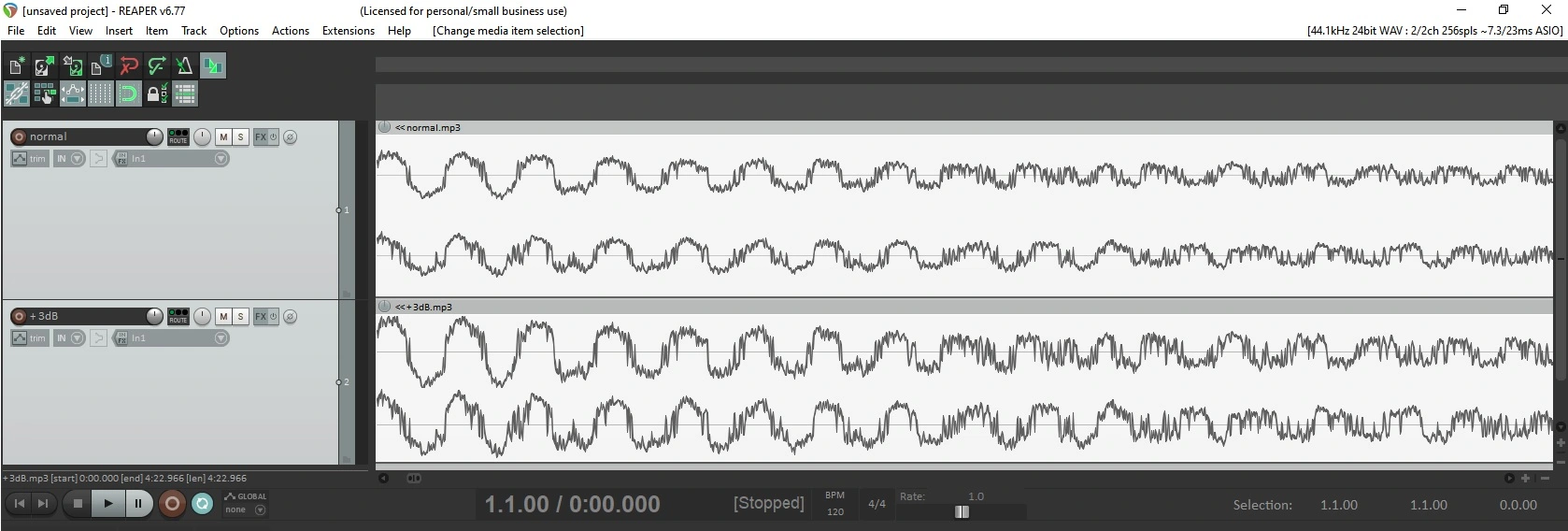

I should have thought to do this earlier... Here's the original MP3 rendered at a lower than usual volume level. Then the same MP3 processed through a 3rd party app to boost volume - volume increased by 3dB.
The boosted MP3 shows clipping in the first half measure.
Then it smooths out for the rest of the song.
Right Spantini, it looks like the very first peak is maxed out which will set the normalization level.
You can see the flat topped peaks pretty easily. As to whether you can hear them is another matter. It it's two peaks out of a 3 minute track, I doubt that anyone would even notice!
