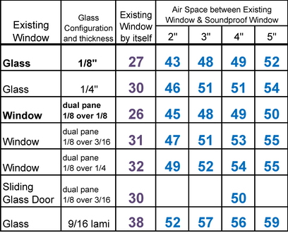

Plug would be the best option, but if you still want light you could try something like this removable double glaze This link is to the Australian product but I am sure there would be a US supplier.
The worry is that 260Hz is quite low and the lower the frequency the harder it is to block.
