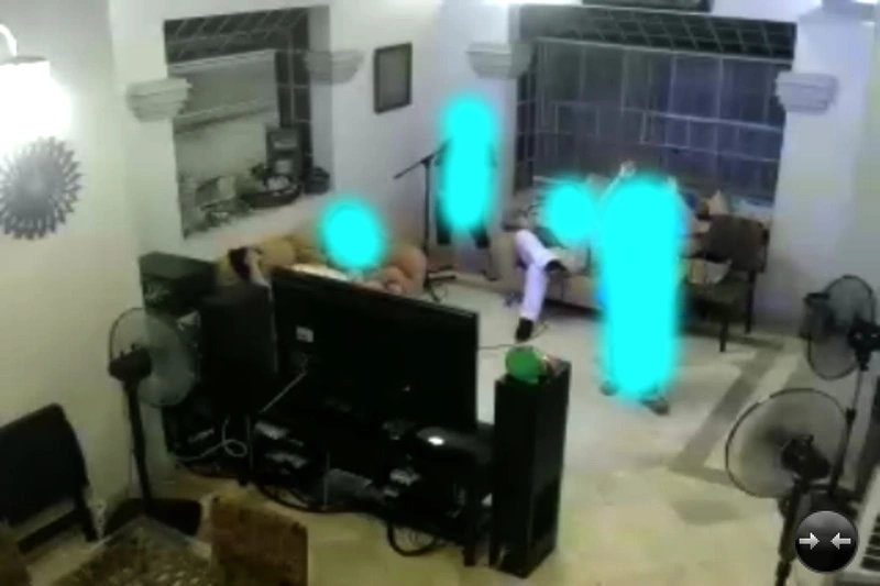

*added: pic of our small living room that houses our karaoke sessions

Speaker - Music is from my home theater system 5.1 which sounds very good. For vocals, I use a single QSC K10 from the main output of our mixer. I place the K10 speaker in the middle by the floor pointing a bit upwards. I am thinking of adding another K10 to make it stereo but I don't know if it would help the sound quality that much. The single k10 is loud as it is. Also, I can't use speaker stands due to WAF and there's really no space to put it since people pass those spaces behind the system. (that's the dining area and that's where we place the food during our party)
Note: I just added pics to my original post so you can see my system.
