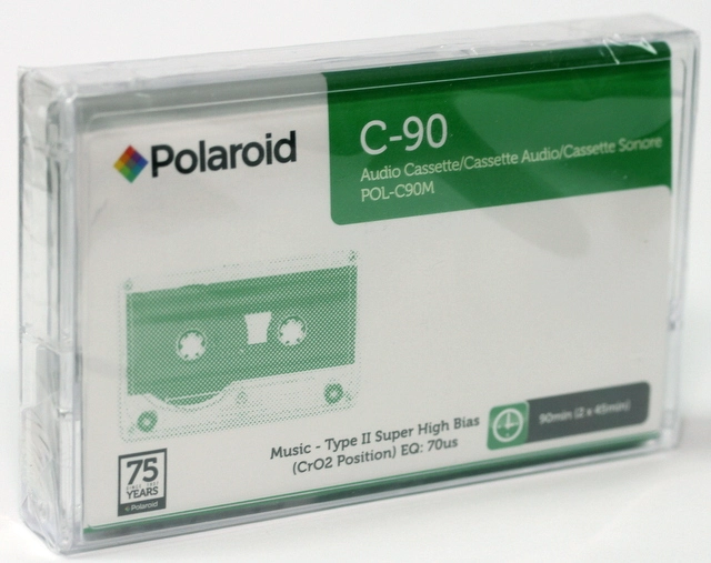

Amazon.com: Polaroid High Bias C-90 Minute Audio Cassette Tape 10pk: Electronics

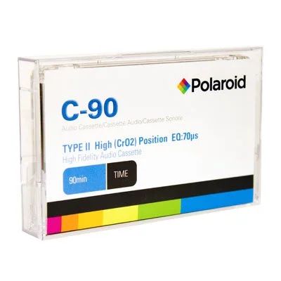

Here's another link for newly made Polaroid. However, these are just labeled C90 & not designated with model number C90M (M probably stands for music) & doesn't say "super high bias" (which is more of a marketing term than a technical one). Chances are it's the same tape in a slightly different label. These are the ones I got,... this style package, not the other ones. Differences are likely only cosmetic. Shipping cost is stated outright, so per item price is $1.90. Still reasonable.
So that's 2 sources of newly made high bias cassette tape. Admittedly, not a wide field but it's there if you want it.
