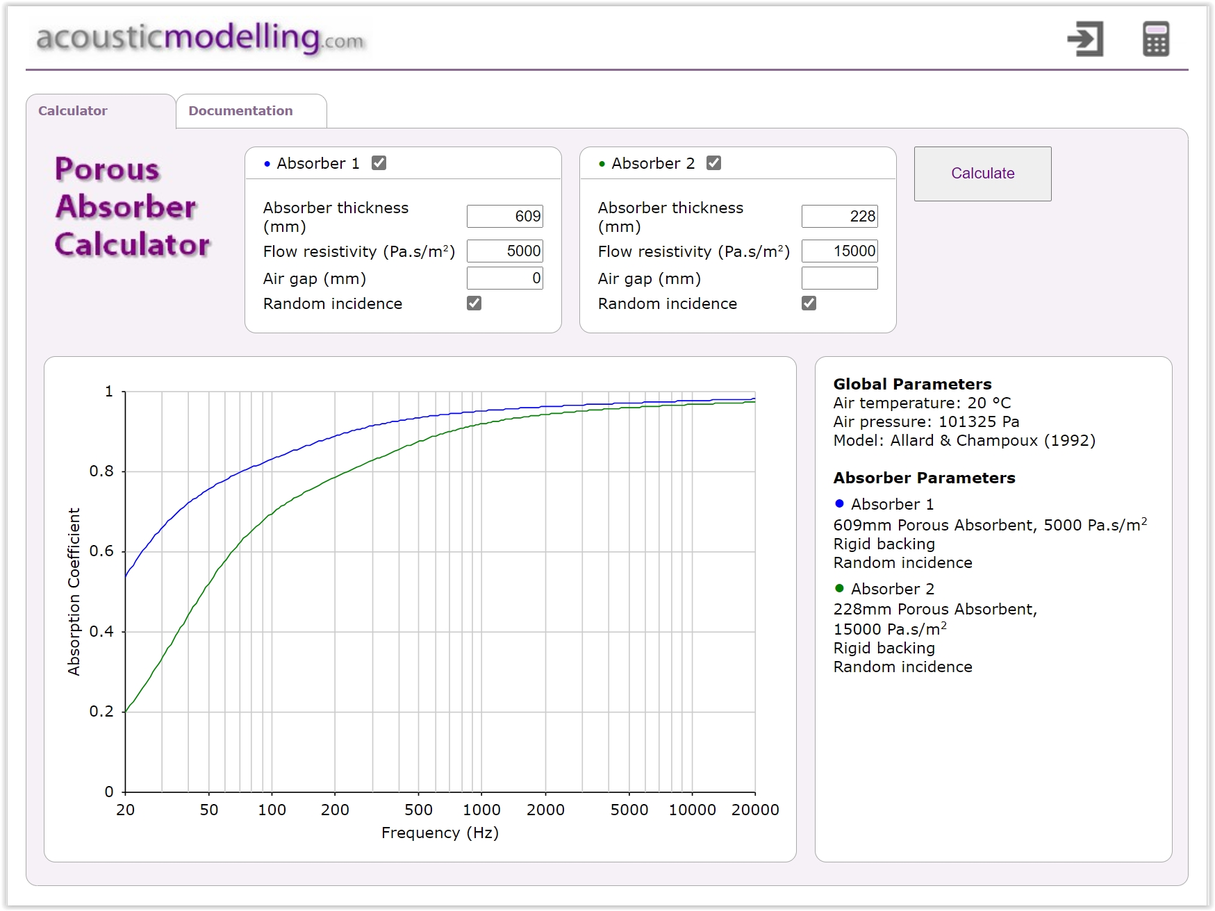

What I had previously was 9 inches of 703 (knauf equivalent) in the corners. Here is a graph comparing low density R38 12 inch x 2 (brand pink) on the blue line vs the 9 inches of 703. Maybe you're thinking, why not just go heavier with 703? At higher density, the gains flatline and eventually low frequencies see the absorber as reflective which is the opposite of what you want. Also I have an attic studio so only knee walls. Giving up that short 4ft high space isn't much of a ask. Going fully across the back was only an additional 4 ft. Add my sub to the equation and I needed absorption that went lower. Last I'll note ratio of absorption to volume of space. I needed more.

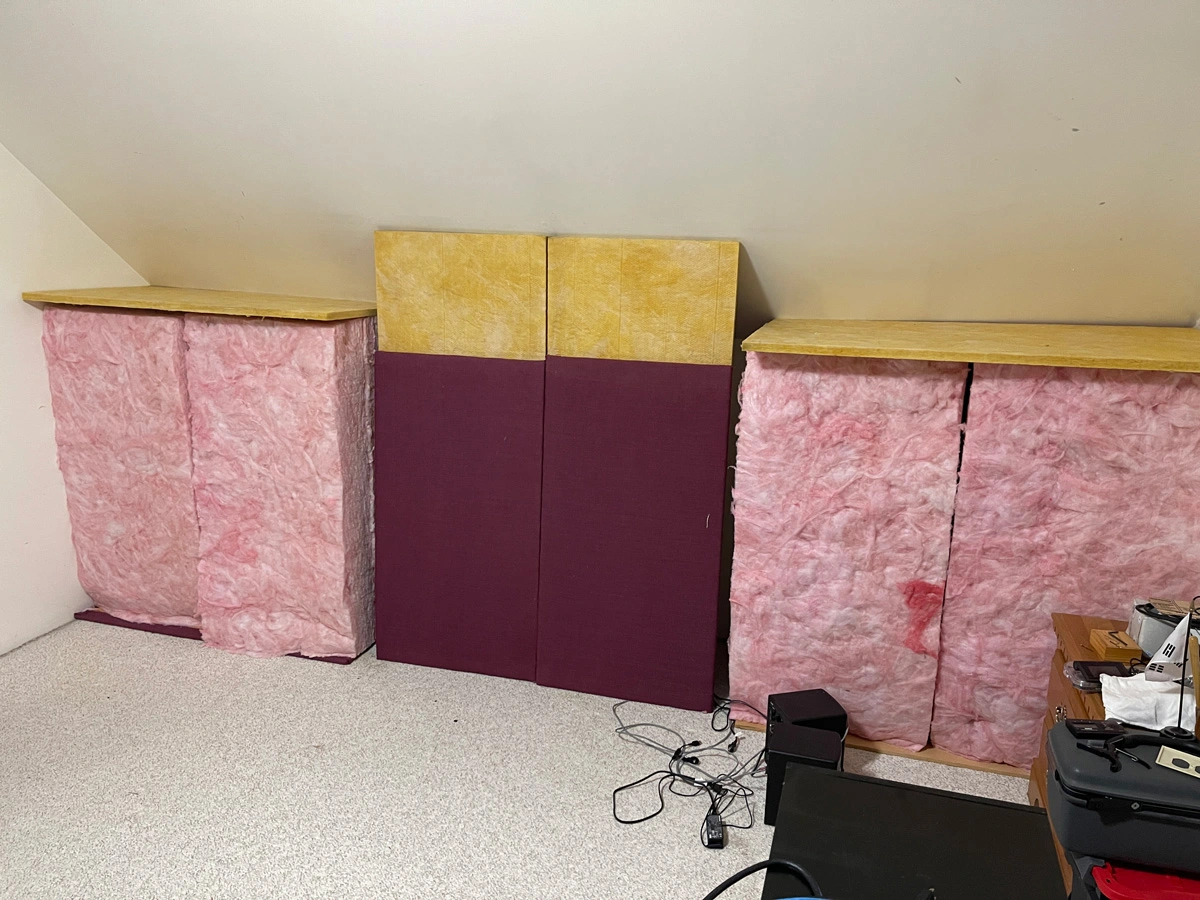

Here is the back wall mock up before I filled the middle. Still working out the room orientation so what is the back wall might become side walls. Filling those knee wall spaces made enough of a difference that I could spin the desk around to face the studio window.
Oh, for sure - knee walls, and hence the sloped ceilings, would be a killer. You should have your pink stuff right up to the slope though, rather than wood on top, as that's creating another hard corner.
It is just a mock up while I work out the remodel and new floorplan. The boards on top are 703 panels just to keep the insulation from flopping over. Going to fill the middle where I've got the old red 703 panels leaning. Got some R30 to cut into wedges to continue up and will then just picture frame the entire wall end to end with dacron and fabric. It is not a very useable space except for guitar cases but did I mention I have a lot of instrument cases. Probably build a rack for them somewhere. Odd note: If you are going to do audio measurements, it is a good idea to remove the most resonant instruments. I had 3 banjos and a pandeiro in the room making a racket with the sweeps.
