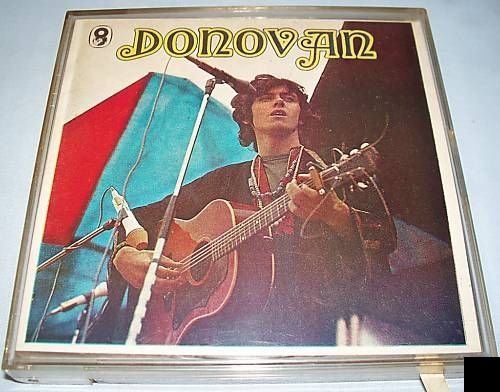

I don't think I've have the pleasure to hear any QUAD amps, but I was reading from the mid-sixties when I got the bug. Not really my budget style hahaha. Higher mid-range sometimes and that can be really, really cheap if no one knows what it is besides a used doorstop. I'm afraid I don't have much from the Islands.. The six-sided Tannoy and I went for the Donovan MONO tape shipped from GB - I had to have it ! Arrived Royal Air Mail. original eBait PIC in the listing

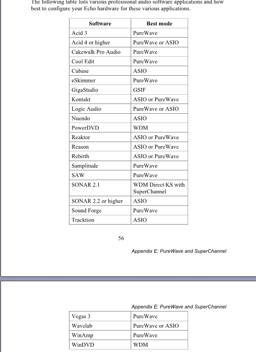

Well, that's how 90% or more of us record our songs. One track at a time. The interface and DAW software work together to allow that to happen. Be sure to use the ASIO driver for whatever interface you purchase.
Hope this helps.
I realize things change, but it's possible the interface MFG has recommendations for each different application
