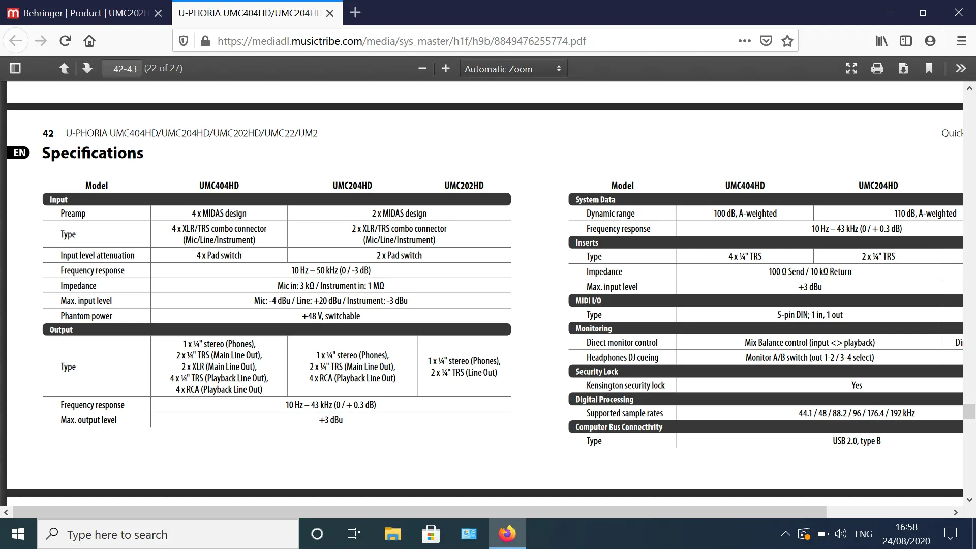

This has my interest because I had a 204HD, breifly, gave it to son in France but I never got around to using the line inputs, just mic but I did yodel into an LDC, the Sontronics STC-2 without problems.
Now, 'bus' powered USB interfaces often get a bad press but the 'ultimate' surely has to be my Native Instruments KA6? Two mic/line in (v quiet) two more fixed gain line ins, four jack outputs, MIDI and S/PDIF and, AFAIK you can run all that at once though I have never tried it. I HAVE however measured the USB current pull and it was around 480mA iirc and 4.8V. I doubt that wee Berry pulls half that.
I have not read of the line inputs having poor headroom, will check the specc' but headroom has little to do with CURRENT draw since the supply rails have to be DC-DC upconverted anyway. If we assume a 12 0 12 volt rail that gives over 100mA of current and that runs a LOT of op amps!
Well the specc shows a very respectable +20dBu for the LINE input but a pretty feeble Instrument figure of only 1/2 volt, is it possible the line jack is TS and switching to Instru input?
I think I shall have to get one again for the craic!
